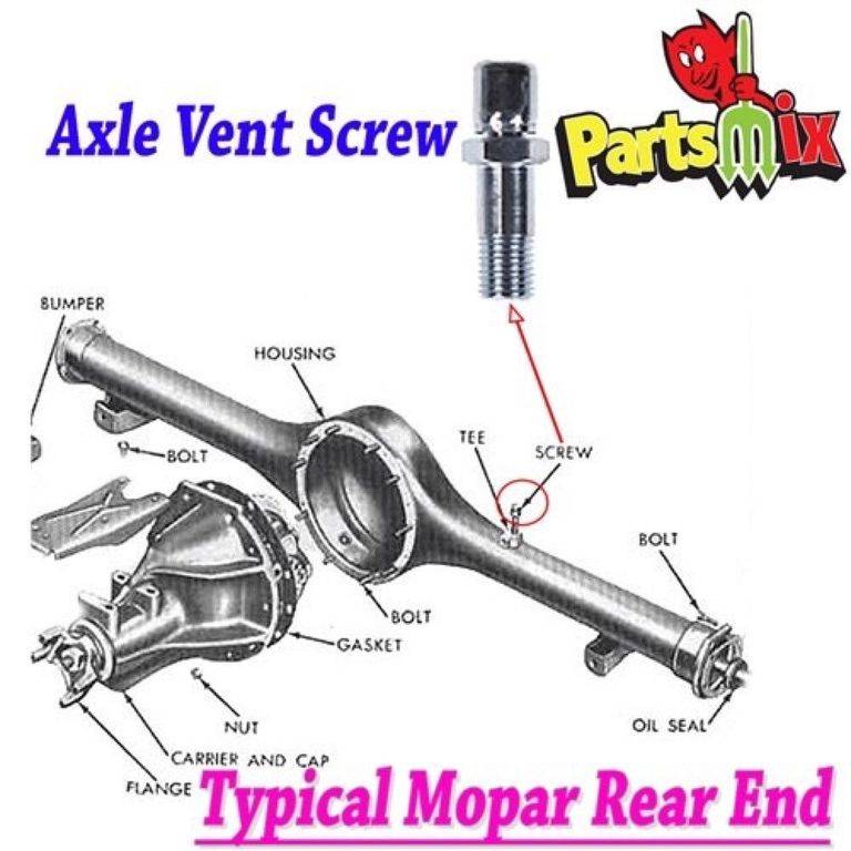

Mar 27, 2018 #1 M mathiew Member Joined Oct 19, 2017 Messages 62 Reaction score 4 Location Canada I look at the oil level in my differential, and I heard pressure sound when I removed the plug (positive or negative I don't know) so I look for any vent, and I don't find any! Does it have a kind of vent on that?
Mar 27, 2018 #2 polara71 Old Man with a Hat Joined Nov 16, 2010 Messages 45,161 Reaction score 25,249 Location Idahoan displaced There should be one on the top of the axle , there is on my 70. It is at the brass block where your brake line is. No picture available....
Mar 27, 2018 #3 M mathiew Member Joined Oct 19, 2017 Messages 62 Reaction score 4 Location Canada ok thanks, I searched on the top of the diff like my Tacoma, I find this this morning
Mar 27, 2018 #4 polara71 Old Man with a Hat Joined Nov 16, 2010 Messages 45,161 Reaction score 25,249 Location Idahoan displaced That's it!
Mar 27, 2018 #5 Ross Wooldridge Old Man with a Hat FCBO Gold Member Joined Apr 25, 2016 Messages 5,944 Reaction score 5,505 Location Scotland, Ontario, Canada And if it's plugged it won't relieve pressure.
Mar 27, 2018 #6 M mathiew Member Joined Oct 19, 2017 Messages 62 Reaction score 4 Location Canada Yes thank, this is why I ask were is the vent!
Mar 27, 2018 #7 Ross Wooldridge Old Man with a Hat FCBO Gold Member Joined Apr 25, 2016 Messages 5,944 Reaction score 5,505 Location Scotland, Ontario, Canada If yours needs replacing they're available new on eBay.
Mar 27, 2018 #8 M mathiew Member Joined Oct 19, 2017 Messages 62 Reaction score 4 Location Canada I just remove it! It work good! It work like a one way valve or check valve, it lest air escape, and no air or dirt can go inside the diff!
