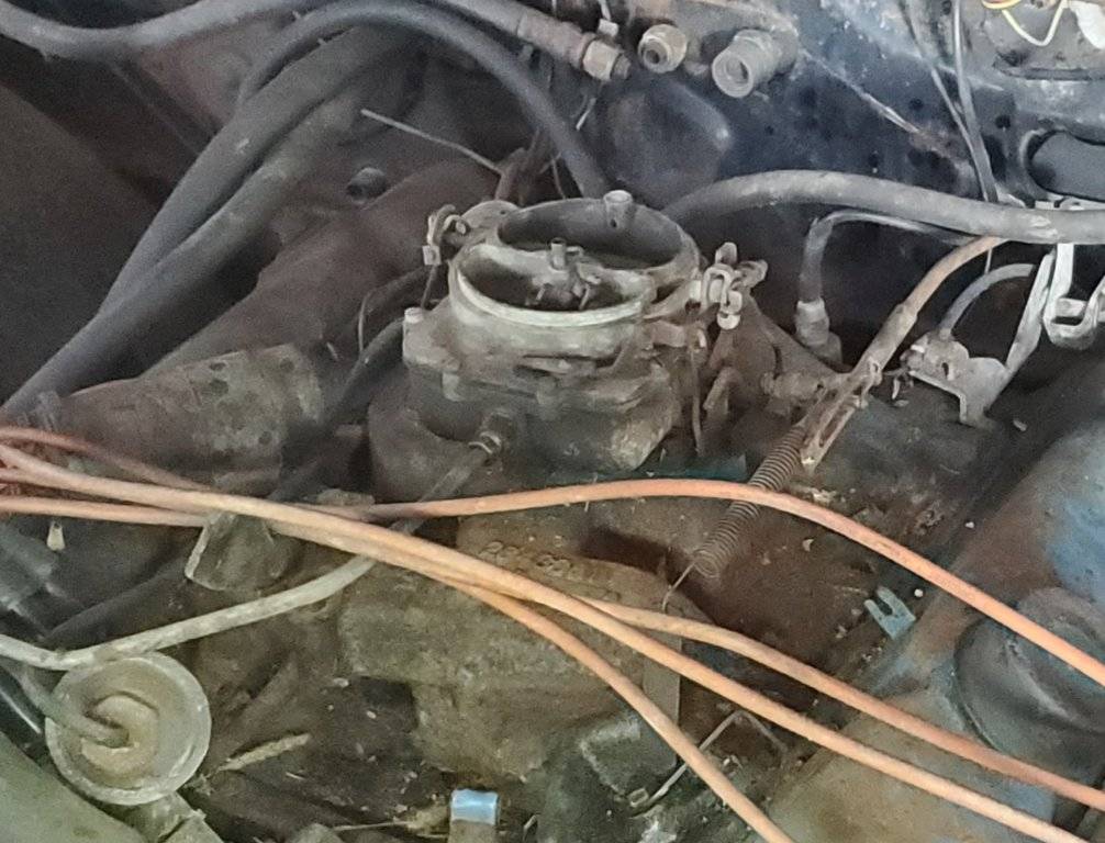

Any idea what carb this is?

Not sure...very new to mopar carburetors...
Not getting far, I do not think on the casting numbers on the intake either-

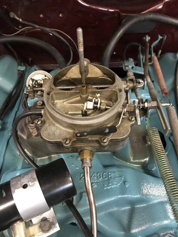

Probably this one.

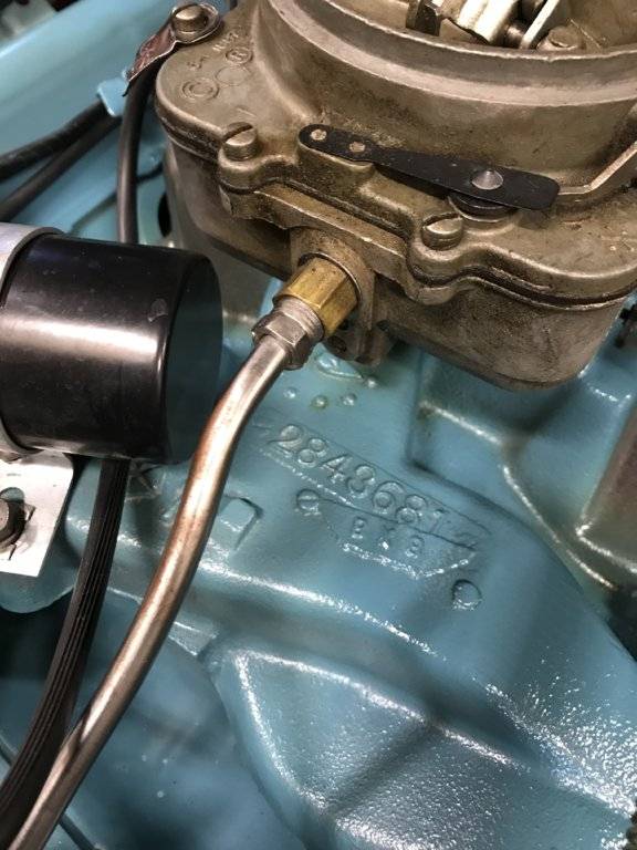

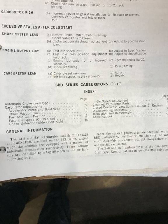

Helpful to supply year. But looks like my ‘68 Dodge on a 383. My tag is BBD - 4423S
Ball and Ball 1-1/2” BBD
Same casting number as mine. STD 2bbl manifold. Not sure how many years it was used. But on my ‘68 Polara 383.
If I am not mistaken Carter Ball and Ball.

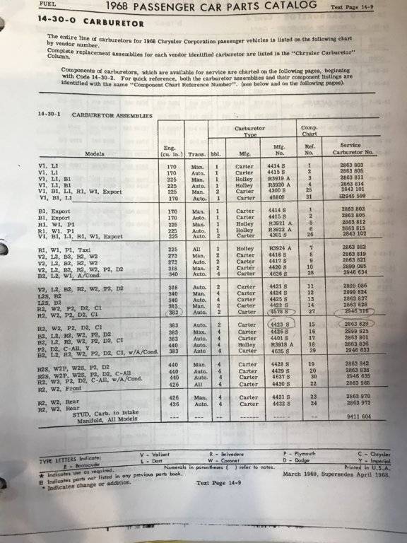

‘68 parts catalog.
If you're looking for a carb kit, probably just one to cover all of the later-'60s Carter BBD 1.5"2bbls, which came on the 383 (possibly some middle-'60s 361, too?). A "28______" casting number would probably have been first used for about 1968 model year (or a model year later?) item.

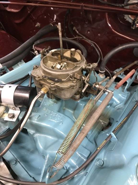

Sir Patrick Your linkage is hooked up wrong, the return spring bracket is twisted around, return spring is too short, and you’re missing the spring on the throttle pressure linkage.
hwyycrzr Your green return spring is in the wrong place, it too low to pull. It should be connected up where the throttle cable is. That’s probably why there is another spring added on, so it will return the throttle.
F*** me.

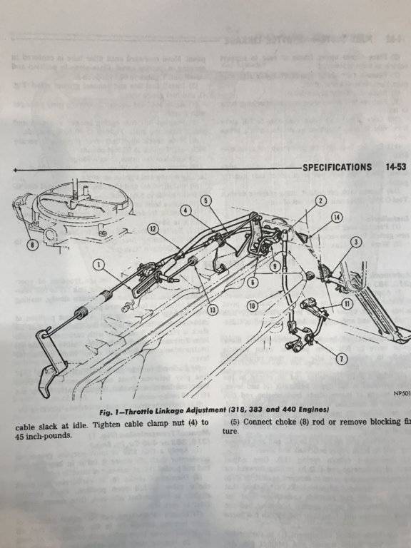

I was about to argue with you. But my service manual was turned to that exact page. I remember that second spring being on there when I started tinkering on this car as a kid. I was beginning to think my spring was week. Then again maybe dad did that to make it harder to go faster when we were driving as kids.
I gotta go try it now.
Does it work better now? Swap ends on the Green spring, it’s backwards.
I’m glad to help out on your nice car!!
the lower hole is for the cruise control pivot link to mount there.
Thanks. It actually returns to idle now. I swear there was an instruction telling me to put it in the lower hole. Probably only bad advice. I think it is fine now. Thanks again.

Looks like I am missing a spring, and the hardware to connect the throttle cable...anyone know where I can find these? As well as a new one to replace the one I have?
