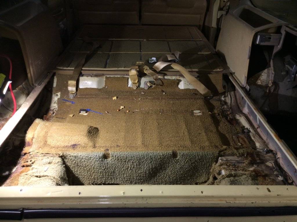

nobody seemed to have pre molded carpet for my 9 pass T&C. SMS sold me the carpet plus a pile extra for the rear. Now Iam ready to fit the rear with carpet. I have that hump on the left to fit and then I have to figure something out for the footwell.
All suggestions and tips appreciated.

I got that far but there is the molded pieces. Steam? Hot iron? Or heat gun and stretch it?
I just laid it in place and placed the seat over it...mine is 9 pass and the carpet does not go as far back as what I see in the pics. Is yours a 6 pass?
For the footwell, I used 2 pieces of carpet.
9 Pass and fairly low miles so I am guessing original. Pretty ratted out. I am just trying to figure out how to lay out the carpet. I assume you glued it all in place? I was thinking of running width wise with the sides and bottom one piece and then a piece down the front of the footwell and under the seat.

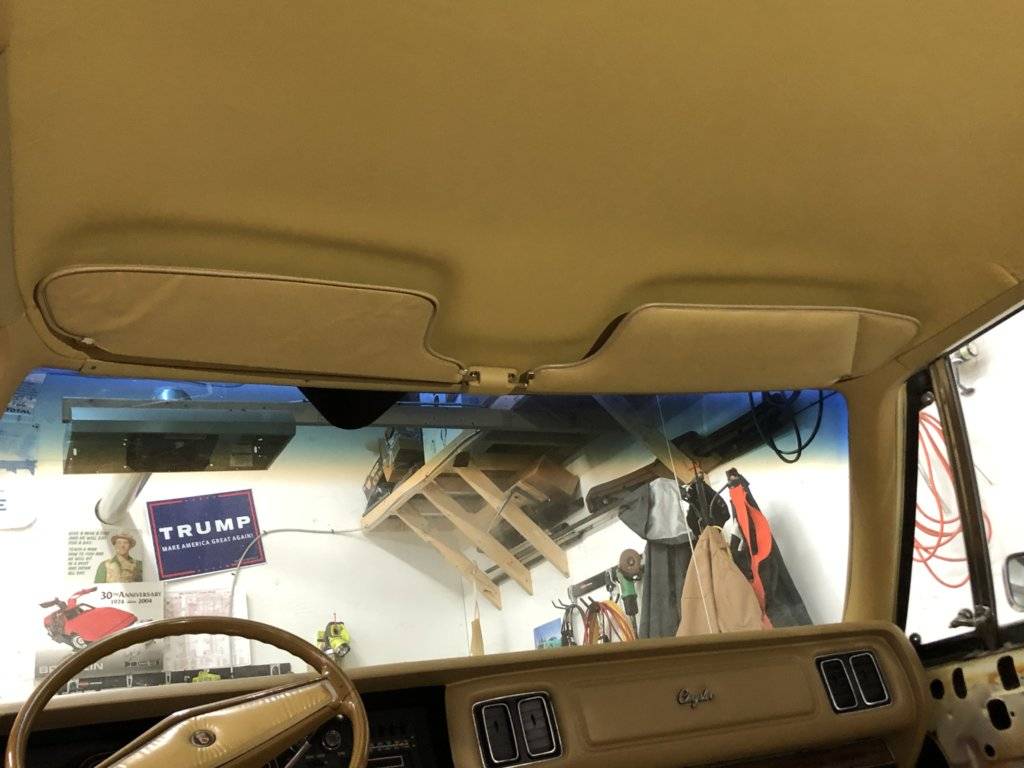

I have found one ‘change’ for sure between this 77 and my other 77 ‘template car’. the headliner support bar in my template car has no holes and does not screw into the roof of the car. The 77 being restored has two screws. Odd.
