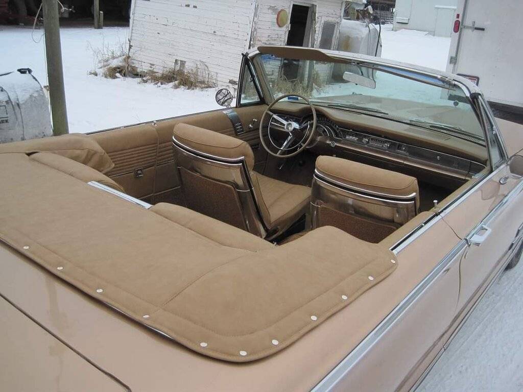

Are they actually available? I had my boot made of the material I used for the interior. On my 66 300, the boot matches the interior, not the top.You will need to order a boot as well.
I got my boot from Legendary, and it also matches the interior.Are they actually available?... On my 66 300, the boot matches the interior, not the top.
Yes they are available you just need to fit the fasteners.Are they actually available? I had my boot made of the material I used for the interior. On my 66 300, the boot matches the interior, not the top.

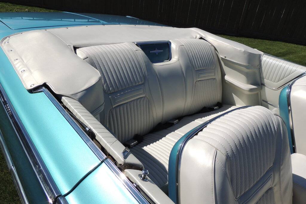

I guess i gotta remember this is a 68 so things could be different than my 69/70 experiences.the well liner fastens on the inside of the top. if i remember right there are snaps on the inside of the trim sticks. it is then glued in place over the rear seat brace.

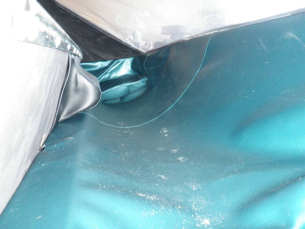

68 should be like my 65. The well liner is sandwiched between the body and the top material under the rear window. This is the best shot I have...I guess i gotta remember this is a 68 so things could be different than my 69/70 experiences.

ah, ok. i didn't realize there was such a variation between the slabs and fusies. thanks.68 should be like my 65. The well liner is sandwiched between the body and the top material under the rear window. This is the best shot I have...
It sits in this recessed flange which goes all the way around...
