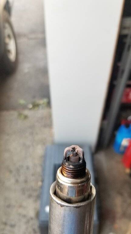

Here is a pic of one of the E3 plugs. The gap is much larger then .035.
I know the previous owner well and have the maintenance log/notes on what he did to the car. I just swapped out the E3s for Champion RJ12C gapped at .035 and I am already noticing a complete difference!
That plug doesn't look bad for color, but if the gap is too wide, that could have been your issue.
