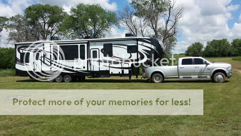

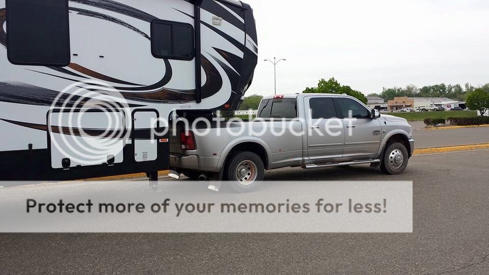

I think I am going to install a set on my 2012 3500 dually. Just looking for advice on whether I should also spring for a compressor, switch , and gauge set or just manually fill. Looking at Firestone bags, but if you recommend a compressor, which one? Best location to mount it?
im not over weight, but she's nose high.
