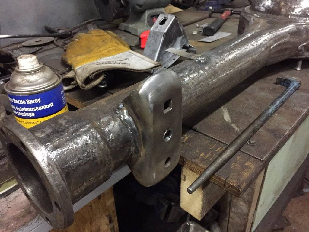

I've modified them, and cut them off and re-welded new ones. I would not do this in the car: figure out how to hold the housing so it can't move (rotate). I had the whole thing on a bench (or floor). Make or find reference points on the housing for each perch so you can reinstall in exactly the same position. You can also make a template to locate off the tube that properly indexes the flat side for the spring. Then cut the old off and dress the old welds. Then install the new perch and tack weld them in place. Then install the axle in the car & check for pinion angle. When that's good, fully weld them but skip around so you don't put a ton of heat into the housing in one spot at once.

Welding on new ones is possible, but you have to watch out because you can warp the housing.
If it were me, I'd try to find another housing. Bet a C-body housing without the center section would go pretty cheap.

Dr. Diff has them for $15 for a pair. Just take good measurements from flange to perch and with a staight edge scribe lines longitudinal front and back of old perchs so you do not lose your degree orientation.

If simply replacing factory perches in the original location, you can use a 3" exhaust u-bolt clamp for reference, make a metal plate that will attach to it and extend to the side to the original perch. Mount the ubolt such that the plate holds the same angle as the original perch, then remove old perch and weld new one on.
That's a simplification, of course, but gives the idea.
