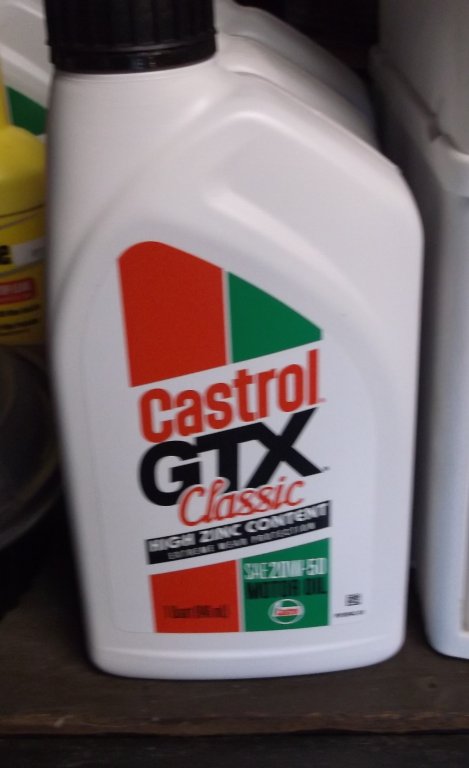

I've been using this.
VR-1 is great oil, but it's not recommended for cars that sit a lot and don't get driven often. I would recommend something specifically for classics and hot-rods.
VR-1 is racing oil and designed for a racing environment - lower detergents, high frequency change intervals.
Diesel oil is designed for running in diesel engines - very high detergents, long change intervals, etc.
For a gas engine I just use regular old conventional oil. Valvoline (Napa house brand), other off the shelf brands, or Kendall or PennGrade if you want to step it up. Use the ultra concentrated zddp additive if you please but it's probably not going to matter.
