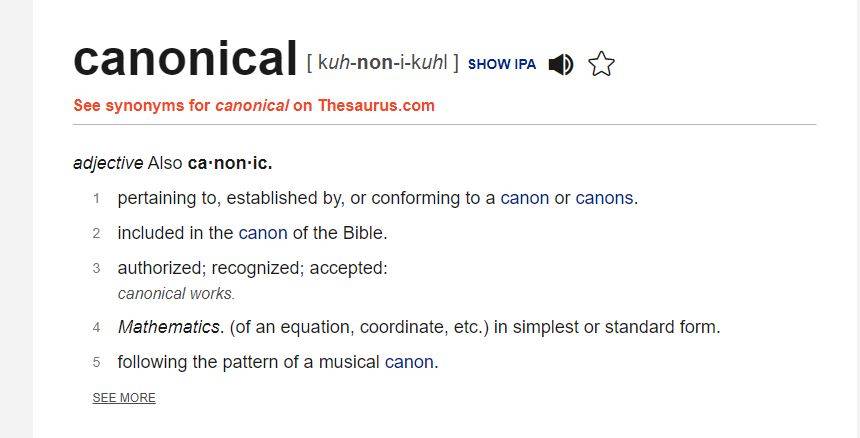

Never fails to amaze me as to the detail of the advice given on this forum. Thanks all! And to those who are wondering but did not want to ask, here is the definition of canonical! Thanks Gerald! C Shaft
