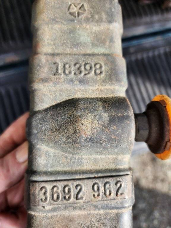

application for radiator 3692 962 18398
marko
Dec 15, 2014
1,619
2,638
Victoria, BC Canada
we've been parting out a 70 newport, was originally a 383HP but has a later 400 in it.
i cant find a source to ID what the rad would have come in.... anyone have a source to search or know what it could have come from ?
tx mark
According to my Galen Govier Chrysler Corporation Part & Casting Numbers Book, 1962-1974 Vol I, 3692962 corresponds to a 1974 C Body, 28” 400 and 440. I hope this helps.
