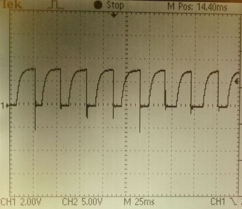

Regarding a distributor with points, are there specs for what is within tolerance as far as opening / closing timing and variability under constant RPM conditions?
I've been making some measurements with a scope when my engine is idling (rpm = 530) and looking at a string of ignition pulses (looking at the voltage signal across the balast resistor) and I see a lot of variability in a single sequence of 8 ignition pulses I've analyzed. On average, the dwell time for this sequence is 29 degrees (duty cycle of 65%) but individually this ranges from 25 to 33 degrees. The resulting RPM, if calculated on a per-ignition basis, ranges from 498 to 553 RPM. The engine does not idle smoothly at this RPM given this variability.
So I'm thinking either there is variability in the valve train / timing chain, or fuel mixture, or distributor shaft / points (spring bounce?) that is the underlying cause for the rough idle. I would assume that the mechanical vagaries of the distributor with points would be much improved by replacing it with electronic version.
This is a 318 with 2-bbl carb, if that matters. I have had a good look at the timing chain and in my opinion there is very little slack in it. The condition of the valves / cam shaft is unknown, but the last compression test I did 2 years ago showed adequate numbers (150-155) and low variability. The points / condenser are new, their pedigree is unknown. Spark plugs are white (after the 850 mile round trip to Carlisle). System voltage while cruising is 14.4 but it can / will drop to slightly under 12 while idling at a stop light. Electronic voltage regulator. Ballast resistor is 0.5 ohms, coil is stock (ie vintage, not new). Idle vacuum is 17 - 18. No idea if idle mixture is correct or too rich or lean.
Maybe the system voltage drop while idling, perhaps the alternator is putting an irregular load on the engine, is causing the uneven idle?
But I'd like to know if the distributor / points could be the cause of uneven / rough idle, or is the carb more likely to be the reason, or system voltage drop (14.4 to 12 or high 11) is - problematic for spark intensity.

To me, I woild be more concerned about the height of the spark plug firing trace. That can vary with compression in the cylinder. A higher spike (more voltage) means the compression in that cyl is higher than the others. Kind of like a "light" compression check? For each firing event, the coil will only produce enough spark energy to fire the spark plug that one time. Even if the coil CAN produce a 50KV spark.
As for "timing accuracy", that can be easy to see in the scope trace line. If using a Sunn distributor machine, there were marks for EACH firing sequence on the machine. Considering the other variables in the plugs firing, I'm not sure than a 1* plus or minus would really matter in a normal, non-race max output, engine.
