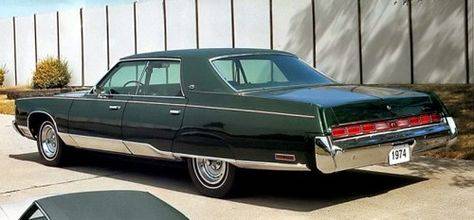

Are these the road wheels that some get excited about???
Woah woah woah.
Who’s formal is that? Looks good.
Make that "Magnum XE", not "Magnum GT". The GTs had a special silver paint on the 15x7s, with the normal center cap and trim ring.
DEFINITELY a nice NY in the picture!

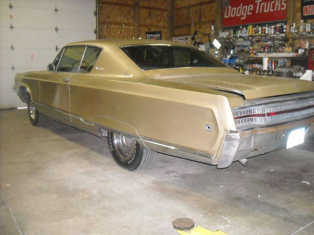

tx, that was 1 of my salons.
at 1 point i owned 2 at the same time and both were sunroof cars..... what are the odds heheh.
yep, my bad, you are right, the magnum set i have has XE on the cap.
(i have 2 sets of these wheels, 1 from a salon and 1 from a magnum.)

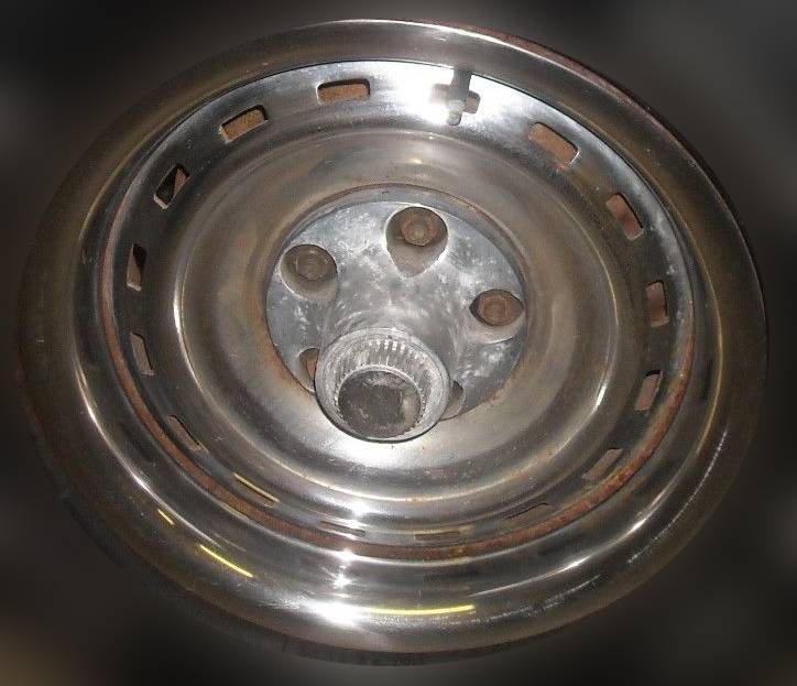

As noted, the first-gen W23 Class II 16 Slot Road Wheels were all 15x6 wheels. The trim ring was squared-off with a concaveish inner section which met the wheel at the chromed slot area. Same wheels were on the '73-'74 Satellites, as a part of the Radial Roadability Package with GR70x15 Goodyear white letter radials. These first-gen wheels were not that popular, for some reason. Possibly a little plain in comparison to some of the fancier wheel covers of that general time?
When the '75 Cordobas hit, that's when they tended to be "everywhere". As noted, the shorter and smooth center cap assemblies. Same squared-off style trim ring, as I recall. Many New Yorkers had them, too. Still 15x6 sizing.
The trim ring pictured in the OP's picture is an aftermarket ring, not a factory item.
There was a 15x7 version that was on the '77 Chrysler LeBaron cars. Not very many of them, either, by observation. Some had a body-color ornament rather than (or assembled over) the silver painted area of the other W23s, except possibly for the SFGT cars. Wider trim ring to match the 7" rim width.
The observed issue I had with the W23s on my '70 DH43 is that the bolts which hold the center caps to the wheel, from the backside, would get loose and the caps would rattle as the wheel turned. The pot metal in the base of the cap is somewhat soft, so easy to strip the threads. OEM uses a special "screw" with a copper washer. Getting it just tight enough, but not too tight, is the trick! Especially on a used cap! The OEM bolts are self-threading, with a taper at the end to assist in self-threading a new center cap.
IF a normal bolt is used, they usually are a hair longer (and not tapered at the end) and will put a dimple on the outside of the center cap base, because of that.
As much as I disliked the exposed bolts on the similar GM wheels, never a problem with stripped threads (as the bolts screwed into the wheel itself) or rattles.

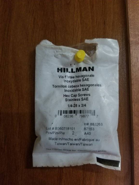

I found a bolt at the Lowe's that is perfect ....

That package hanging has old dome screws in it. These new screws fit perfectly snug. No play, no dimple but I must admit I was cautious about possible penetration of the screw.

So, was the '74 use limited to the B-body cars with the Radial Roadability Package? The only C-body application in '74 and later (I'll have to check my sales brochure archive for the '74-specific availability) were the "Cordoba" smooth caps. Key issue would be the '74 model year.
Thanks,
CBODY67
I think the little picture in this '74 Chrysler Brochure answers this question. The road wheel photo has the tall dome with the splined cap.

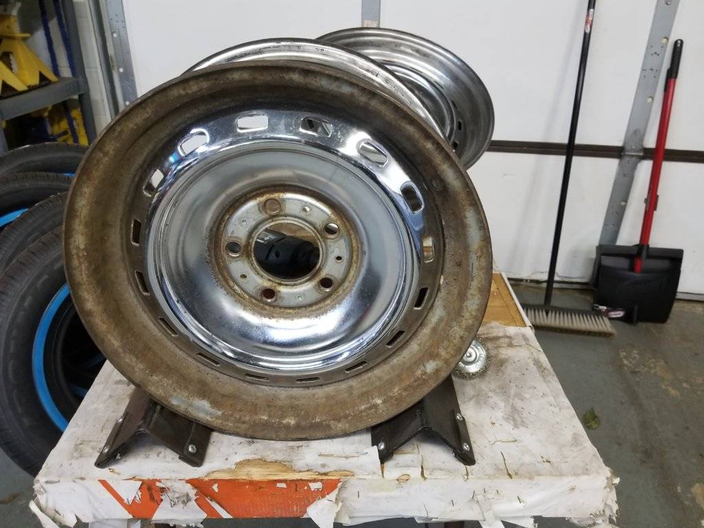

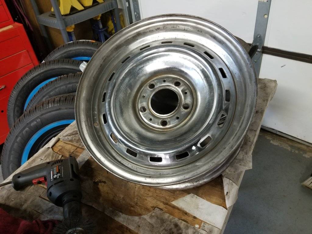

Reading through this thread, it got me thinking if the Magnum 15x7 road wheels recently purchase for the 71 New Yorker, will clear the front disc brake calipers.
I've been cleaning these up using a brass wire wheel and will have the tires mounted and balanced when done. They're driver quality, but when done and the center caps and trim rings go on, they'll look much better than what's on the car now.

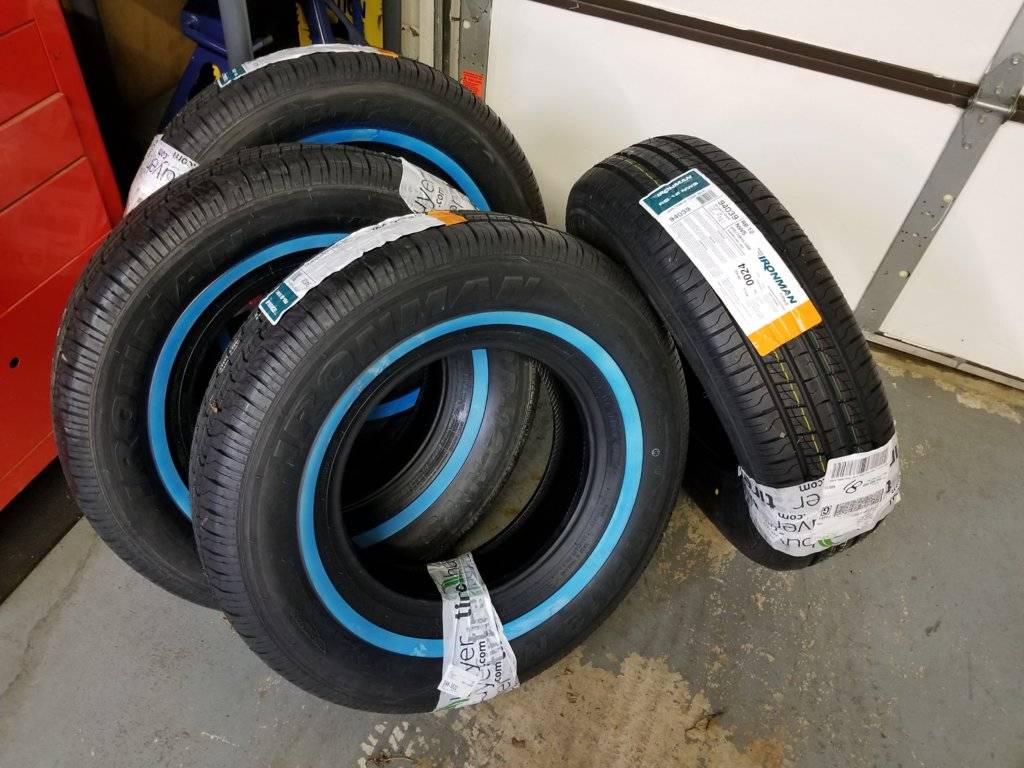

My girls bought the WW tires for me on my b-day. All 4 were $269.00. They great kids.
