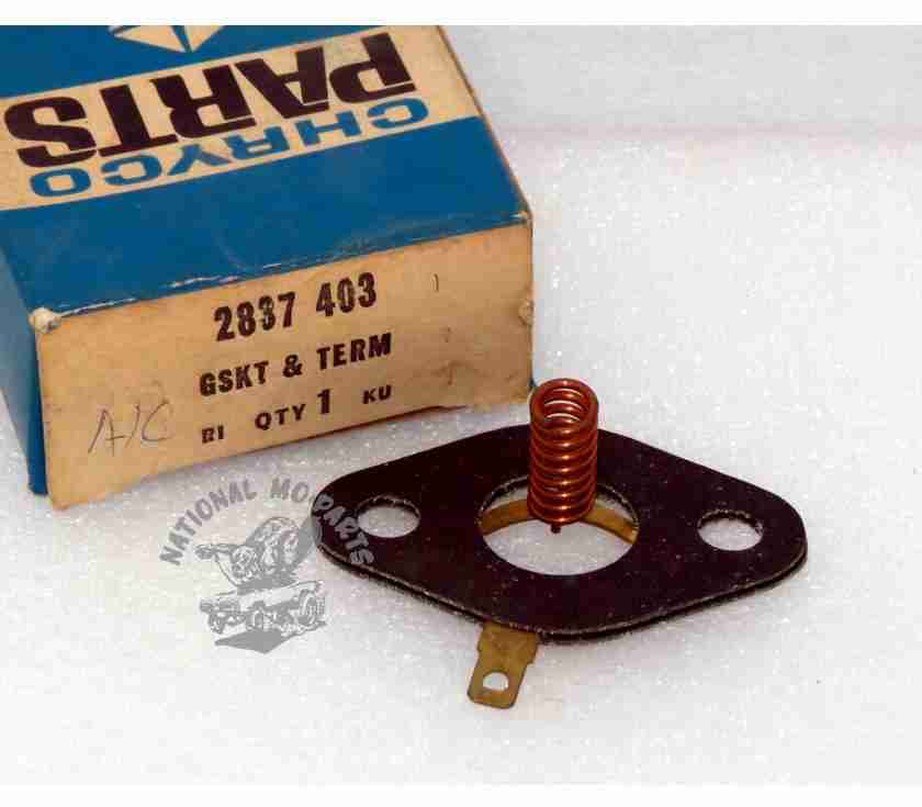

Years ago, a friend was parting out a '70 or so NY. Where the EPR valve would go, there was a brass wire mesh item there, with an elec connection on it. Never yad seem anything like that, but later research indicated it was for an AT system. Never did understand why electricity needed to be there, or if it was just a "convenient" place for a ground>
