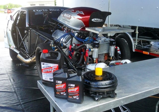

A lot of my ProMod friends run Super F in big 2500 - 3000 HP engines that are exceeding 900 cubes. Of course this article is biased because they are trying to sell the product....but you can understand the properties and performance of the fluid in this article.
http://www.dragzine.com/tech-storie...e-f-inside-atis-super-f-max-duty-trans-fluid/
And if you’re wondering about compatibility — ATI has successfully tested and recommends the Super F and Max Duty for use in virtually every common automatic racing transmission, including the GM Powerglide, TH350, TH400, Chrysler Torqueflite 727, 904, and Ford C4 and C6. At this time, only electronic transmissions are voided from the list.
