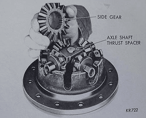

At this point, I have no idea what the problem could be. The only thing that would make sense in my brain, is the little dowel/thrust pin in the center of the True Trac which "floats" between the axle shafts. Could that have been ground of with driving for some reason? It seems highly unlikely, given that it should be hardened steel and is fully covered in oil, but I just can't think of any other cause to my problem.

Is the thrust spacer still in place?
if the ends of the axles look fine I'd be pulling the diff to take a good look at the thrust spacer...maybe a junk aftermarket piece that wasn't properly hardened? at this point I don't trust anything new...
Yes, that’s what I am thinking too… Do you happen to know the dimensions of it? I might make one myself, just so I know it’s proper quality.
honestly no...never even removed it when I replaced the clutch plates...there are NOS ones on Ebay but i have no clue if the Eaton unit would take the same one as a SureGrip...maybe contact someone like Dr Diff?
I'm not a fan of Green bearings, but this might be one where it could be a good solution. The Green bearings were first used with spools where the center spacer wouldn't stay in place.
I don't think that center spacer is worn out. It may have fallen apart as I have heard of that happening more than once. Probably the place to start is pulling the center section and making sure that it's in one piece.
