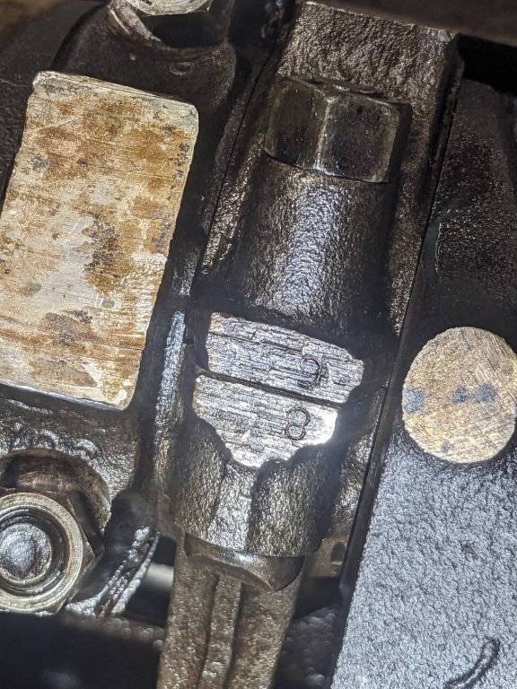

Thank you very much for the help. As you can see from the picture... well let's just say I found some discrepancies.
My eyes are not as good as they used to be, and most of them were not as obvious as this. Some had a single number stamped across both rod and cap. So that was fun.
However, we got it sorted and now the engine is spinning freely again. I learned a valuable lesson. I will be marking them next time.
