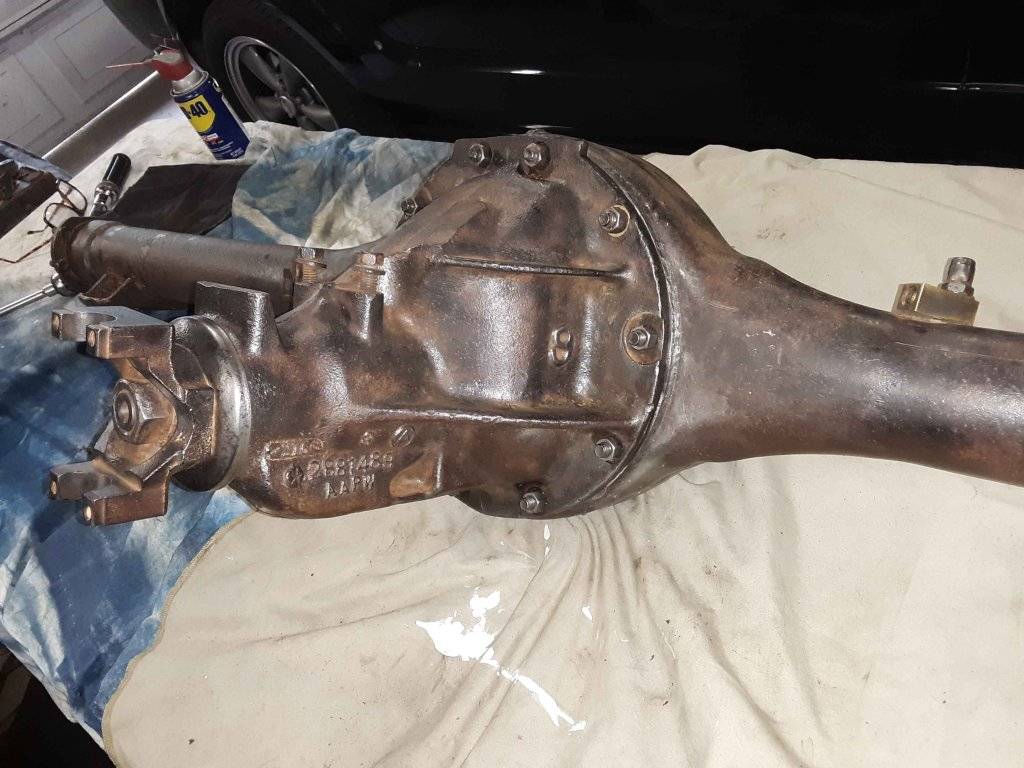

1st we need to know if you have an 8.75 inch type axle. It has a removable differential, that removes from the front like the axle pictured below. It does not have an oil pan at the rear, that you would remove to access C-clips. As stated before it does not have a C-clips..

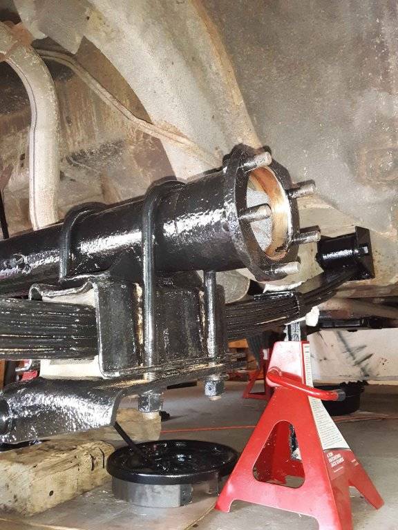

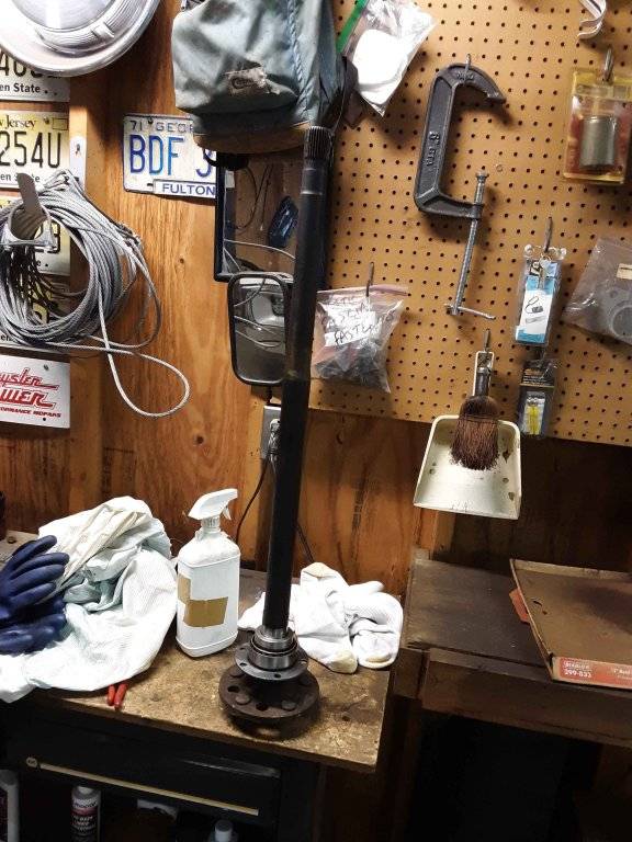

The 2nd point is that the nuts to remove an axle are on studs that go through brake backing plate and the plate that is pictured to the rear of the wheel hub on this 8.75 inch axle shaft. On the right side one of them has an adjuster fitting. It is very important when you reinstall the axle shafts to install them with correct end play. If the end play is something you can barely feel, you probably got it right.
