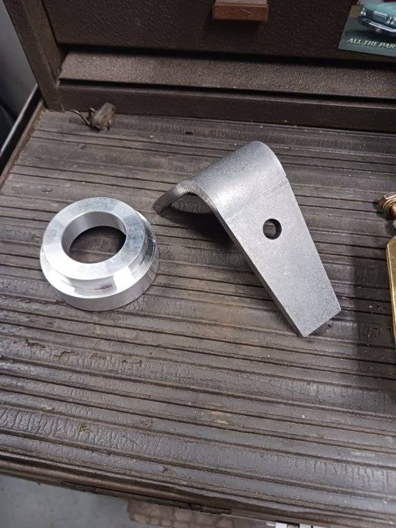

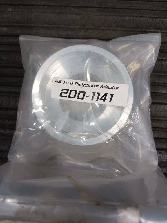

Mopar Performance used to sell and adapter tube to use a RB (longer shaft/housing) distributor on a B block. Spaced the distributor up a bit. Had the needed gaskets/seals on the ends. Worked good. Had a longer hold-down clamp/bolt for it, too.

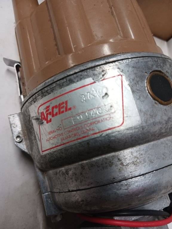

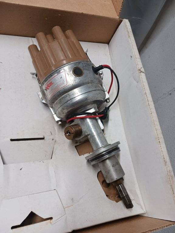

Accell made low deck tach drive distributors. I have a DEI version converted to a Pertronix and a dual ooint that I never finished converting. From memory there was never a p/n in the DC catalogs for a low deck tach drive model in cast iron or aluminum.
Do you have any kind of part number on that Accell? Sounds like what I’m looking for, if not electronic then something that can be converted

If I was going to run a tach drive distributor I'd pick up an aluminum DC rb tach drive distributor and run the spacer. It's easier to work on the engine with a little extra clearance between the cap and passenger valve cover.
Luckily there is a place in texas that makes tang driver adapters (and much, much more) needed for a DC tach drive unless you stick with a SW tach. From memory the Accell dist uses a square drive and so does my Moroso (Jones-Motrola) tach.

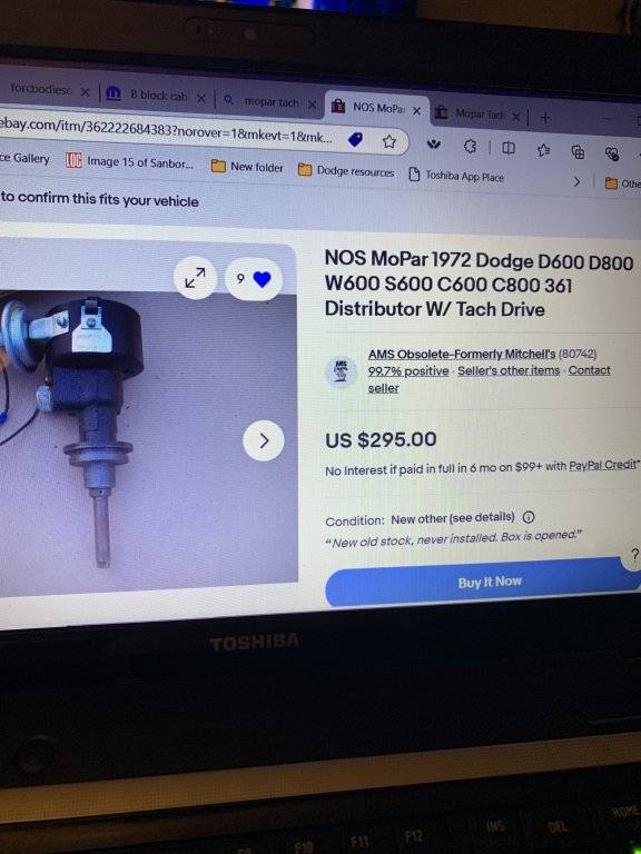

Found this truck unit on eBay, fits, got the VA, good shape
Thoughts?

Did not even go into the truck books!
I was looking at the cable drive low deck truck distributor on eBay myself. That might be your most economical alternative. If it was me I would stab it in and check the curve with the engine running before trying to change anything. There can't be that much of a weight difference between a c body and a dump truck LOL.

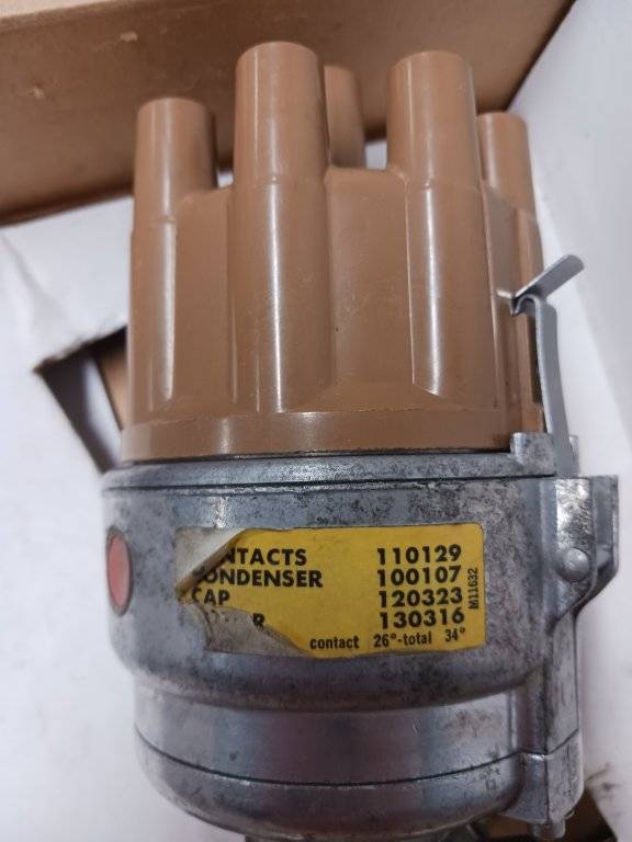

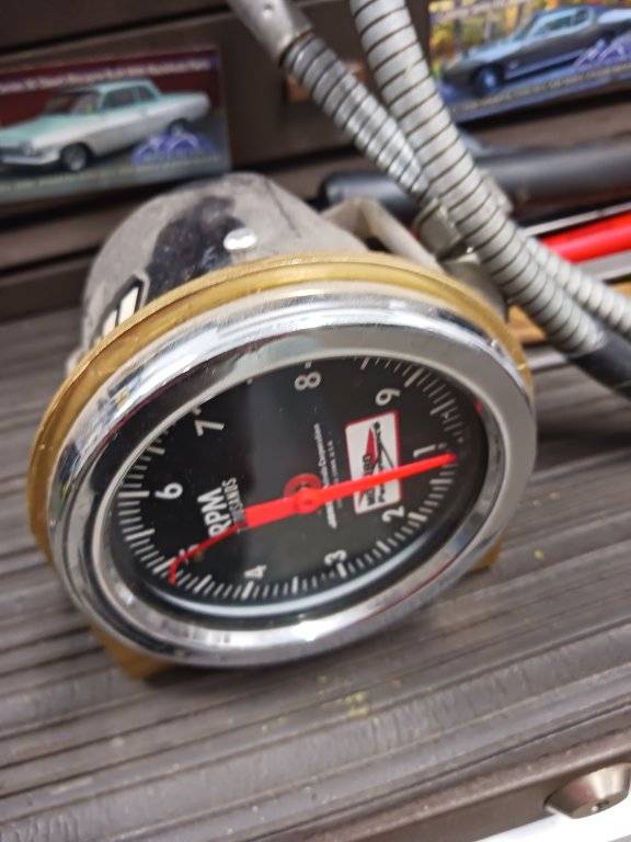

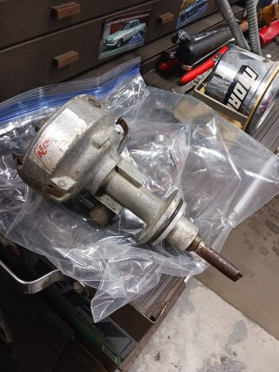

I am attaching some photos of my low deck tach Drive distributor stash, the RB to B distributor adapter and a .187 tang drive to square drive cable adapter.
