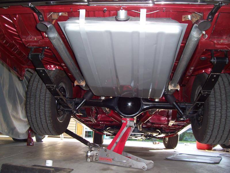

Just bought a spectrum tank for a 68 Roadrunner instead of the Fury tank. Note how the straps are offset but it is mounted solid with no problems Joe
nice thats exactly what I'm doing, do you by chance remember what the model tank you got was? CR9C is what I ordered...
so tank came in, compared to my old one, its about 2-3 inches longer which I think should be fine. I just ordered the filler neck grommet and I am trying to source the tank pad...can I just go to a fabrics store and get some kind of felt and cut it to size?
I also googled it and saw people using roofing tar paper as a suitable replacement...what are your thoughts?

View attachment 36551This is a b-body tank on my 1968 Fury
I also have a Fury (1967), and I was thinking about using a Coronet tank & sending unit. I have a couple of questions if you don't mind my asking.
1- our tanks are 23 gallon, I believe, but most b-body tanks are 19 gallon. Do you notice a big difference?
2- does having a smaller tank affect the gas gauge? is the needle off at all?
3- do I have to seal the inside of the new tank? or does it come sealed?
Your car looks awesome from underneath BTW.
