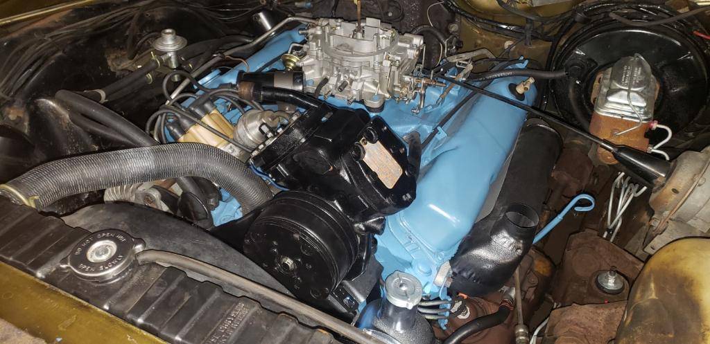

Two weeks late to the party, what did you get in the end? I have Gates on both of my fusie Dodges. Several thousand miles overall and no issue yet. Here is a photo taken yesterday by @71Polara383 showing how they sit in Medina, my 1971 Monaco.

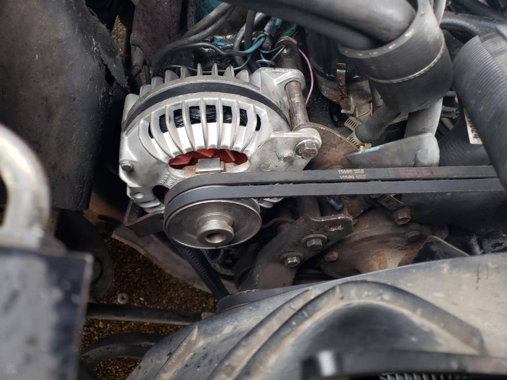

Here is a photo from a year ago (before the engine was cleaned and repainted), showing a different angle.
