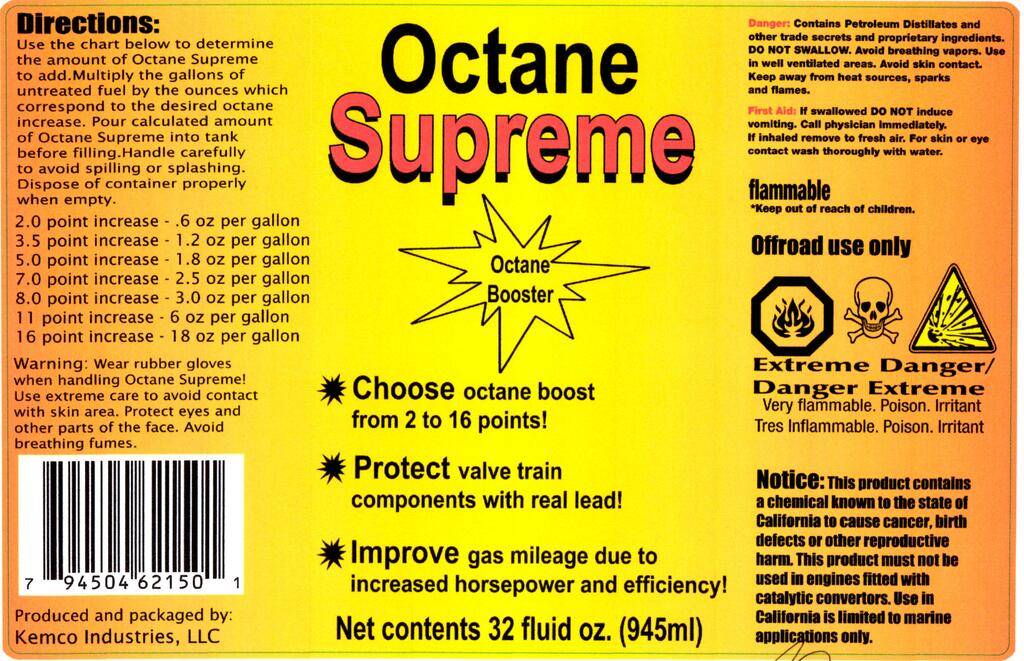

Looks similar to the ratio of toluene. Maybe it is also toluene with added lead? Very expensive stuff!
Qty Description
Price
each
1 Quart metal can Plus Shipping $24.95
1 Case Quart metal cans (6 ea.) Plus Shipping $145.00
Multiple case pricing below reflects lower shipping costs
2 Cases Quart metal cans (6ea.) (2X6 = 12 total) Plus Shipping $290.00
3 Cases Quart metal cans (6ea.) (3X6 = 18 total) Plus Shipping $435.00
4 Cases Quart metal cans (6ea.) (4X6 = 24 total) Plus Shipping $580.00
6 Cases Quart metal cans (6ea.) (6X6 = 36 total) *** FREE Shipping *** $860.00
