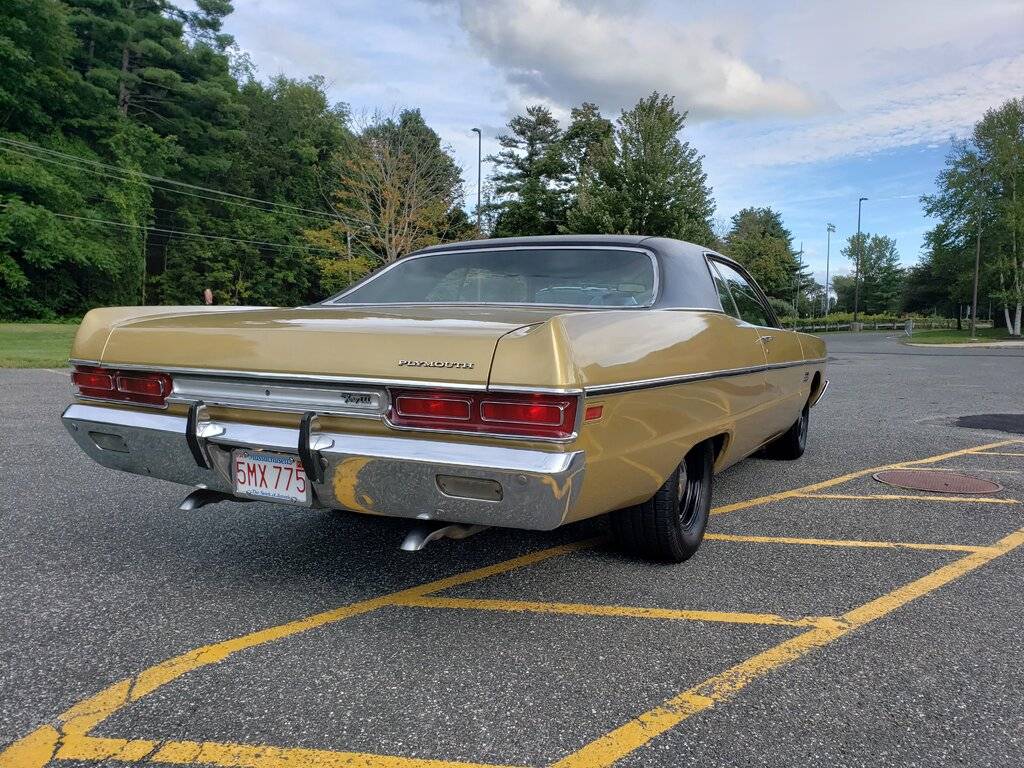

For my 69 Fury III 440 when I got the car I told my muffler/racer guy I wanted a full rich fat sounding exhaust with no tinny twangy high partials in it. {It had blown out glass packs that sounded like ****} I also said I don't want it to sound like every Challenger/Cuda I see at car shows ,which means no Flowmasters. Nothing against Flowmasters as they are a classic sound I personally hear too often. He gave me a set of Magnaflows and I couldn't be happier even years later. I will be very interested how they sound with my 512 ci stroker when installed.
