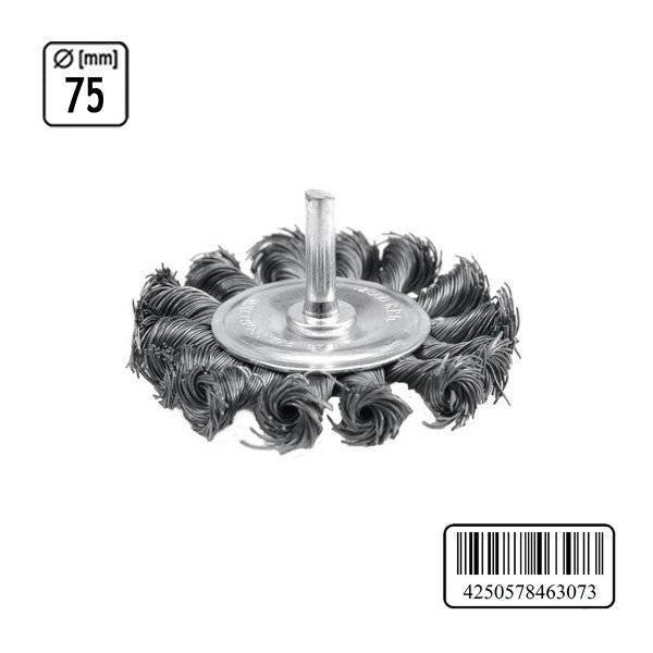

Birthday present:
It should go without saying but a point of caution, do not use this on panels you want remain without some deformation. Try it on a floor pan first, you'll see what I mean if you don't already.
I use that Kind of wire brushes, they're not all that tough to the surface but clean up very well, too. Reaches most of the problematic narrow places as well.
I have an open wound, well it's almost healed, from having that knotted wire wheel on my grinder. It slipped off and touched the top of my knee. It's only blood.
I use the Version for the power drill with a bit lower rpm. I once used an unknotted wire in the air grinder for a second, after which I had two wires stuck in my nose just from spinning freely. Memo to myself: pay Attention to max. rpm for that stuff.

I NEVER use any type of rotating tools or equipment, (grinder, wire brush, buffer), without wearing a full face shield and gloves.

I used safety glasses for 20 years, switched to full face afterwards. ;)
