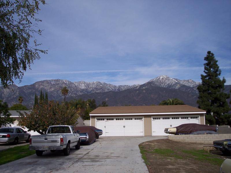

Now I get to really enjoy my backyard. And it looks like this most days of the year now.
