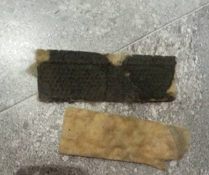

The culprit. A couple of pieces of insulation. Easy peasy. The only thing that was a b!t(h to do was unfasten and fasten the 1/4" sheet metal screws that hold the blower assembly in place. No easy access and the ring it mounts into is crooked. The top screw was halfway under the firewall edge.
