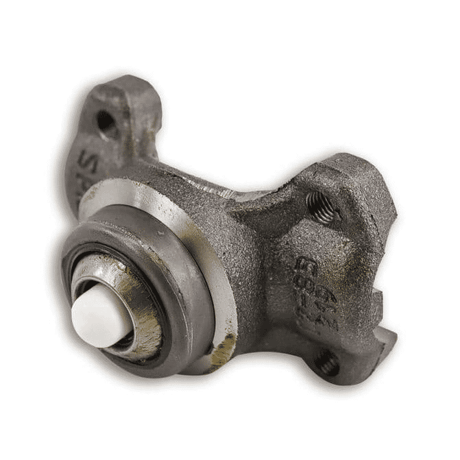

I am just about to do the u-joints in my Imperial. The joints are very tight with no play, but off idle on up i get a woop woop with speed and a vibration at highway speeds above 65. I think it is also the Double Cardan CV Centering Yoke
That now seems to be out of stock every where I look suddenly.

An update.... I replaced all the U-joints but since I couldn't find any replacement listing for the centering yoke or the ball, nor could I find anything NOS. so I didn't try to change it. That was a mistake... Got it all back together and when I move the yoke, it still catches like it did before. No joy....
So, I did some research, actually a lot of research and I think I've come up with the proper replacement. (EDIT: Link to incorrect centering yoke omitted to stop any confusion. This one was wrong, see my next post) I matched all the dimensions to my existing yoke. I ordered one from Amazon (cheapest and fastest) and it should be here Wednesday or Thursday. BTW, the application listing seems to be early 80's Ford Bronco.

A swing and a miss on this one... The centering yoke came in last night's Amazon delivery, including the driver tripping and falling on the porch in front of the Ring camera. Everything matched except the center post diameter was wrong. I thought I checked that, but the new is 1/2" and the old is 5/8", so must be I didn't.
The center pin in question.
I tried the two driveshaft shops in town today and no parts... I could order a new centering ball for $100 from one, but I wasn't confident that it would be correct... and $100 for this centering ball is a bit ridiculous. T
So, keeping with my track record of learning some things the hard way... I left the driveshaft at the better (of the two) driveshaft shop and they are going to weld on a new double cardan joint and I'll be done. That will take care of any balance or phasing issues at the same time.
