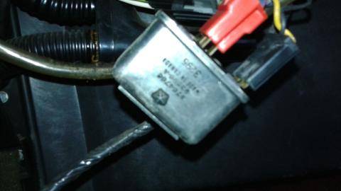

ok guys,my blower motor does absolutely nothing.It has no power going to it so i took the dash apart to check there.i dont have a service manual so i just check all the wires i could get to and it did have power at some of the terminals.I then found the blower motor resister and every single terminal had power there (which struck me as odd).I know i need a manual but in the meantime can anybody tell me what this is and if it has anything to do with the heat?
Now, we're talking...you probably have a vacuum problem- look for two round vacuum pots on the passenger side mounted to the airbox (one yellow, one green) with wires going to them. If the vacuum pot is bad- no blower motor. This is easily tested either by first pulling the vacuum lines, making sure you have vacuum...if so, capping them and then one by one hooking them up. If they work you'll hear "click" and the blower should come on.
