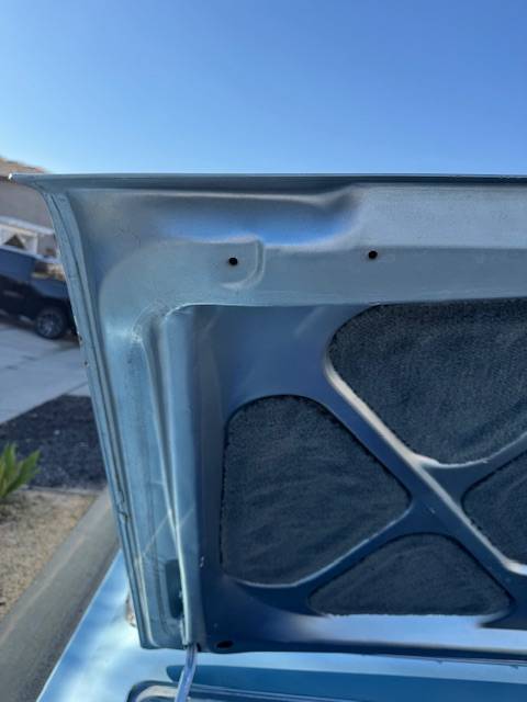

I recently purchased this “Body Bumper Kit” to replace some of the brittle/missing ‘bumpers’ under the hood.
The parts I needed for the hood were easy to figure out. I even figured out which parts were for the doors (apparently 3 out of 4 of my door bumpers were missing…. The 4th one was just barely there).
My question to all of you smart people is if you know where the rest of these smaller ones go?

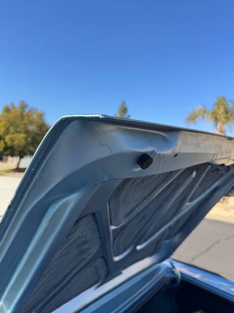

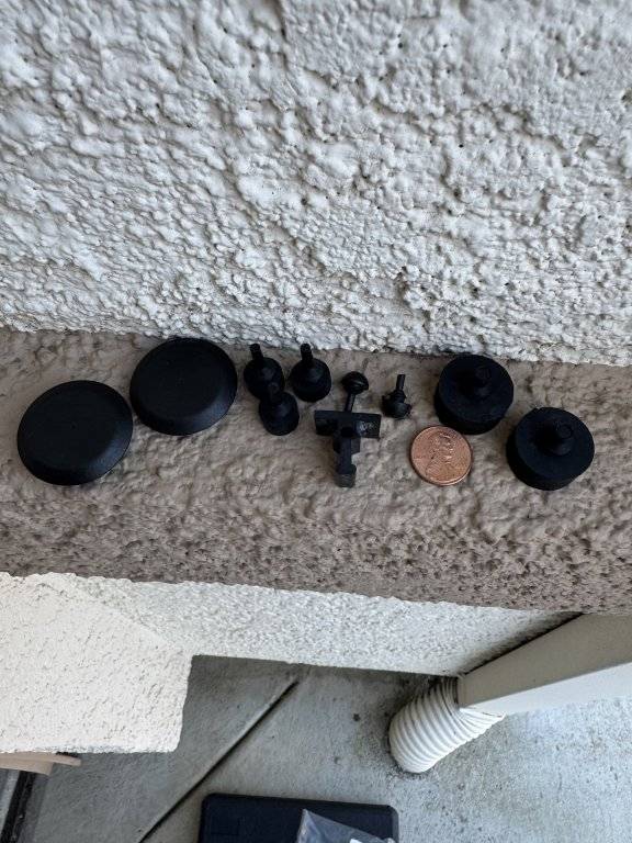

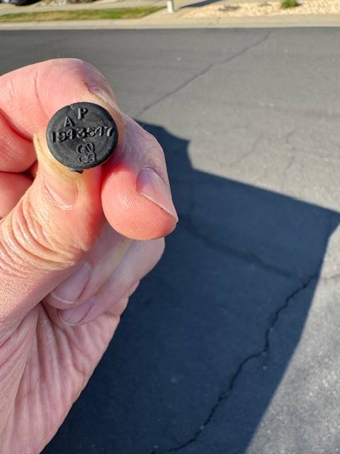

@HWYCRZR thank you again for pointing me in the right direction. The small round ones were indeed for the glove box.
On closer inspection too, the cylindrical ones had reproduction part numbers on them and I was able to confirm they were for the trunk lid and license place.
Here’s some pics:
Part 2784714
Part 1943547
I am not placing that one. What door or opening is there only one of? Console ashtray. I don’t recall anything like this on my Polara and my ashtray doesn’t have bumpers.
Might just be a mystery to be solved for another day. Like @CBODY67 suggested, I will hang on to it until some day it reveals itself (or not).

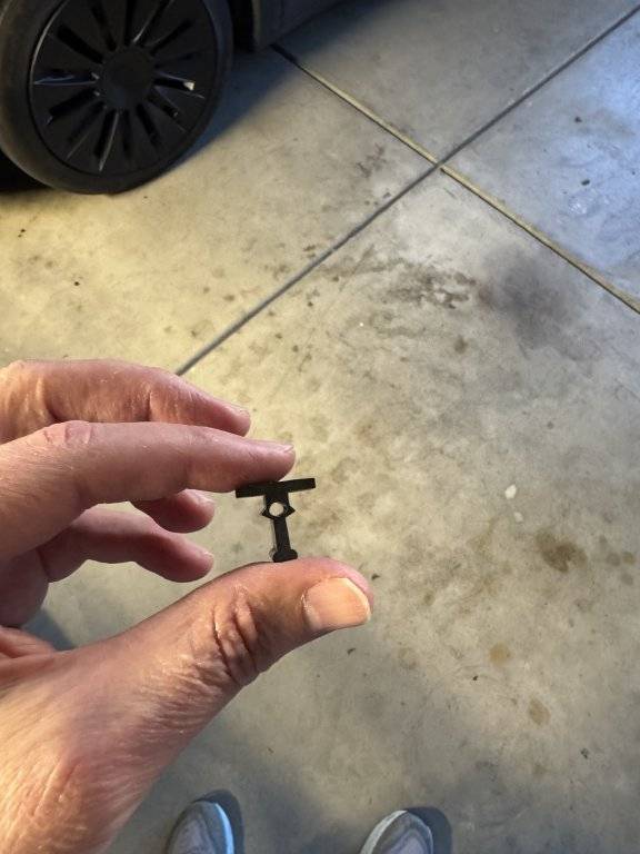

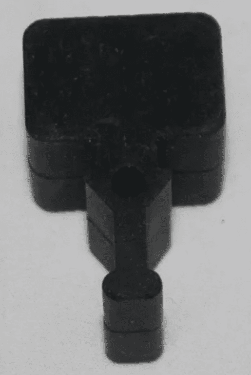

Now this leaves me left with the single T shaped one. No numbers printed on this one.

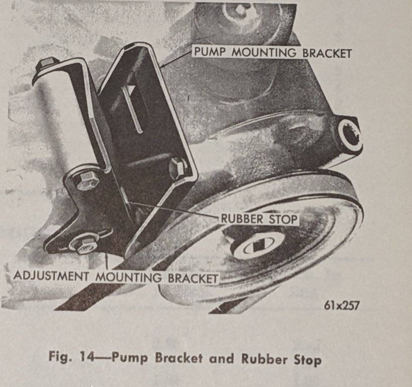

The rubber part in the image is the clutch pedal upper stop bumper. Chrysler number is 1940147 for C-bodies. It was also used on some power steering pump brackets, 1960-1968. A/B/E-bodies plus light duty trucks used a similar bumper, Chrysler part number 2266820.
Well I’ll be…. Thank you @Vaanth !
Any chance you have a picture of one installed on a power steering pump?

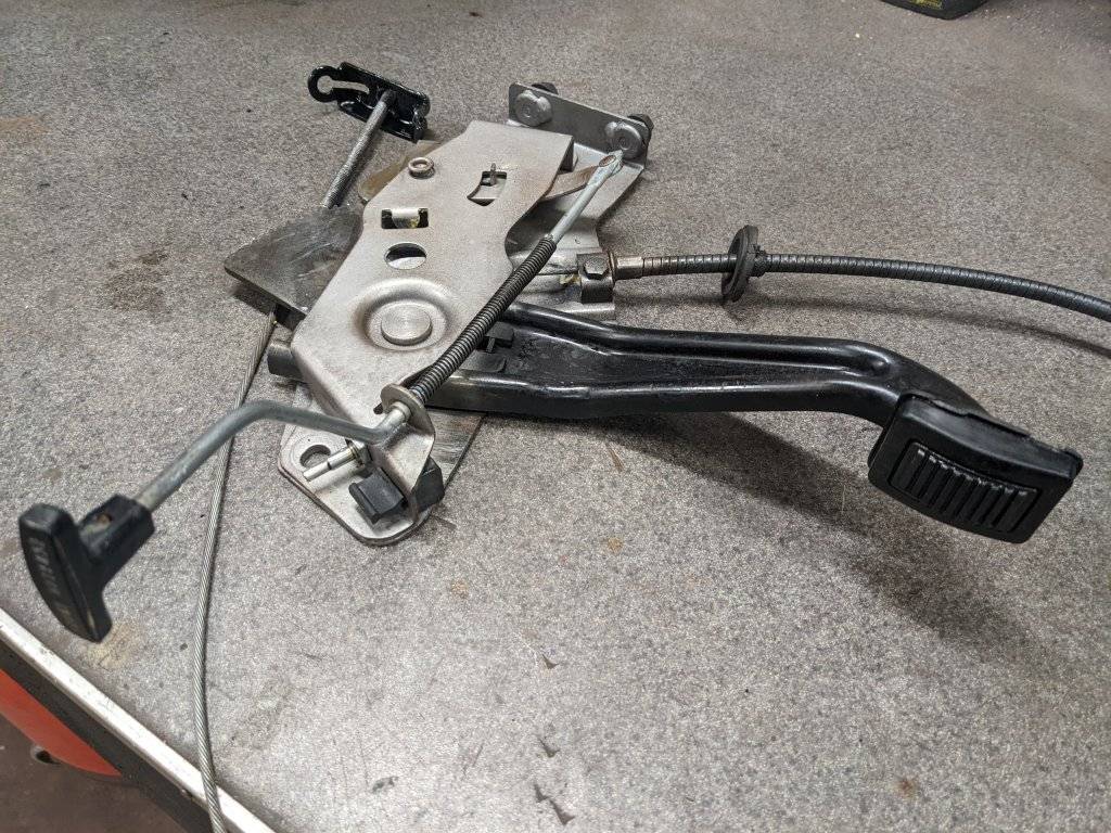

The parking brake lever bumper looks similar in cross section to the clutch pedal stop bumper, but it is heavier with a much thicker pad. Chrysler part number for the 1968 C-body bumper is 2467515.
The installed park brake lever bumper can be seen in the following image. This is from one of my Challengers, but the bumper is similar to the C-body although the axis of mounting differs.
