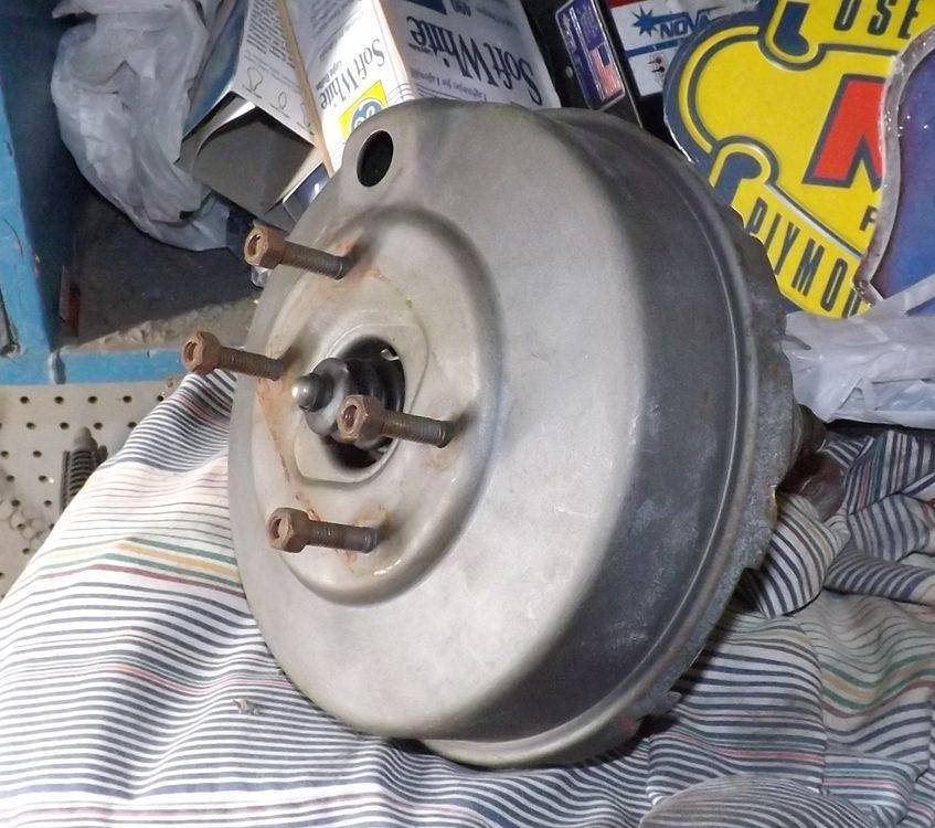

Here you go? Grabbed it from his ad
This is a drum brake booster and won't be as efficient as a dual diaphragm unit.
