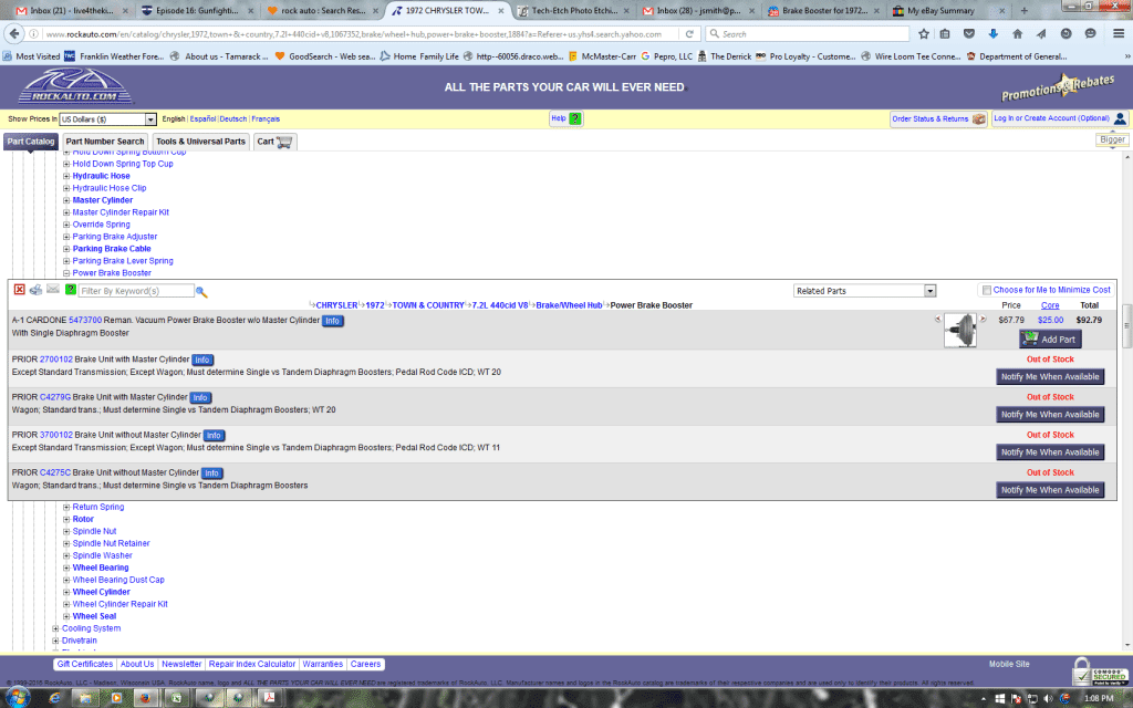

May 18, 2016 #1 R rggale New Member Joined Jul 31, 2015 Messages 5 Reaction score 0 Location NJ Hi folks, Looking to replace my leaky brake booster in my 72 T&C wagon...and can't find the proper part number, or source for one. Any advice? Thanks!

May 19, 2016 #3 R rggale New Member Joined Jul 31, 2015 Messages 5 Reaction score 0 Location NJ It seems like the correct one is 54-73604....Rock Auto says that's from a 68 not a 72. Interesting....confusing. Another case of "throw on whatever's in the parts bin"?

May 21, 2016 #5 P polarus Senior Member Joined Feb 22, 2013 Messages 2,084 Reaction score 1,656 I checked my parts book, station wagon power booster field installation, four wheel drum # 3549942 drum/disk part # 3580073. Hope this helps.
