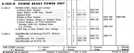

Will 1968 & 1969 Chrysler power disc brake boosters, (bendix type), interchange.....? The 1969 parts book shows part # 2883091. Does anyone have a 68 parts book and can reference the PDB booster number....?
Thanks,.
68-booster-info.jpg is this it ?

I'm converting my 69 300 from power drum to power disc using all the componants from a 69 300 pars car. The parts car had suffered a underhood fire that pretty well cooked the booster.
The fact that you retained the drum, (midland-ross), booster and cylinder and it works ok is huge to me........ That would eliminate a bunch of expense and work.
It could be a difference in pushrod length between 68-69. I think the 68's used a four piston caliper and the 69's used a single piston. Not sure if the pushrods are interchangable but the booster is likely the same.
I think i'll go ahead with the swap and deal with the booster if I need to.
