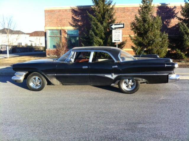

Nice 60 Dart.... Love the forward look's
