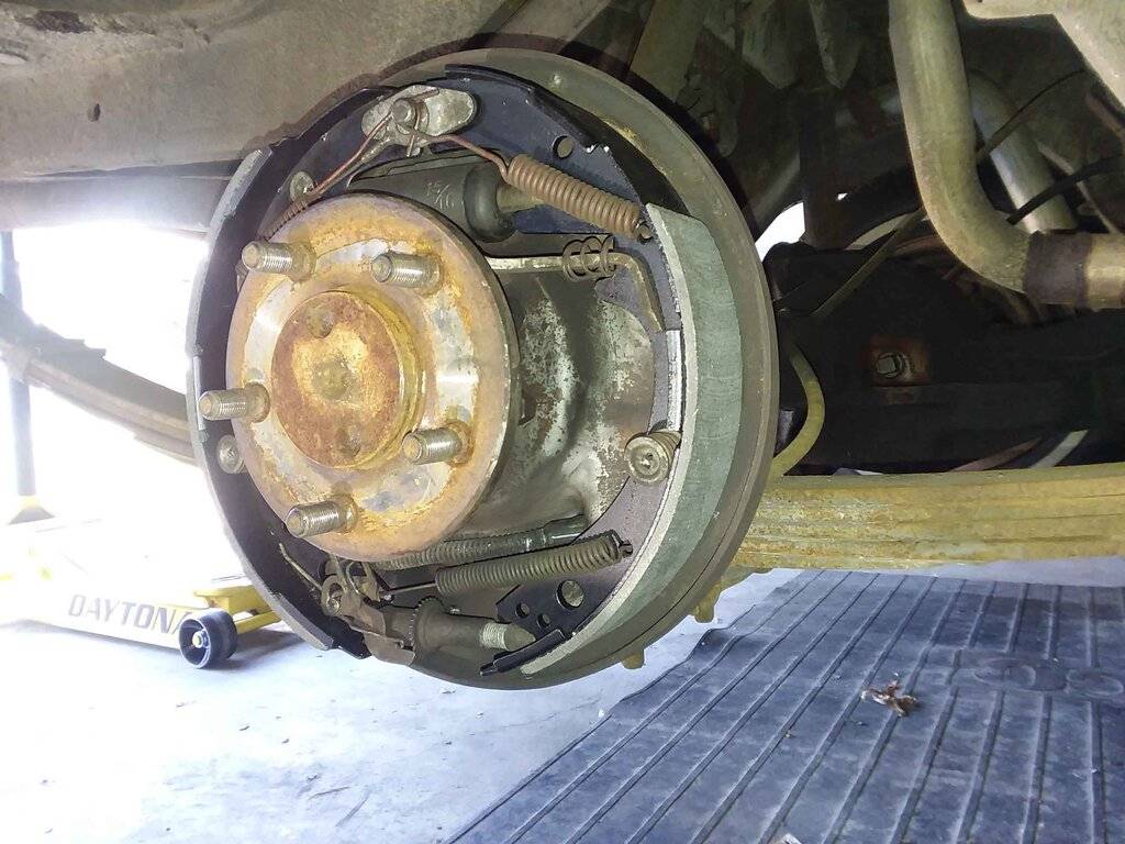

Since one side is smoking and the other is not, I agree with ruling out the proportioning valve and master cylinder, because both cause the same action at both rear brakes. Since only the driver side is smoking, driver side is either adjusted too tight or the parking brake cable is sticking, continuing to activate the brake even when the pedal is released.
2 Checks
  1. Brake Adjustment: Jack up the rear of the car, trans in neutral. Spin the driver side rear tire by hand. If it spins easily with a light rubbing noise from the brake drum, your adjustment is probably OK. If it's hard to turn, you will need to remove the tire and brake drum and use a spoon/screw driver to narrow the brake adjuster. (Adjuster is the toothed circular part at the bottom of the picture. Turn the toothed/gear part to shorten the adjuster.) Reassemble and spin again. Continue adjusting until you get the condition originally described.
  2. Parking Brake Cable: Assure parking brake is released. Remove tire and drum. Pull the cable end with pair of needle nose pliers. Cable should move. If not, stuck parking brake cable is probably the problem. In picture, parking brake cable is directly behind and above the lower brake spring.
I also agree that you need a new mechanic. His diagnosis is faulty.
