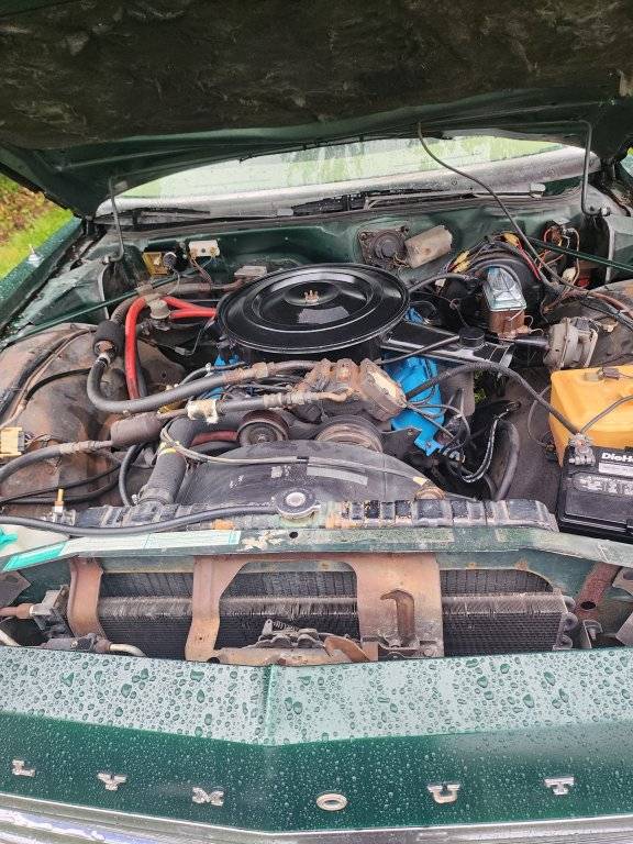

Hey gurus, I need help on how to reset brake light on in my 1974 plymouth fury iii 400cid 6.6l. Also the damn thing keeps blowing fuses, especially the dorm light

The brake light came on after the brake master cylinder overhaul. The fuse got cooked when i use turn signals

Hey good people! Thank you for all your ideas on how to reset the brake light on the dash. The issue was resetting the proportioning valve, I had to turn the car on/accessory then press the brake pedal all the way to the floor then released it slowly that is according to owners manual. This car is about to mess my brains up man. After fixing the brake light, i got no dash lights, and the sucker shakes when starting it, then it stops after it gets warmed up. At some point it died on me when i shift the gear from parking. Any help would be greatly appreciated.
