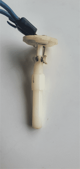

The blue wire connectors are mounted on the cap of the white plastic housing. The cap is glued on but with a sharp slim knife I was able to break the connection cleanly by being careful and going all the way around and not just force it at one end.
Components:
Center white stalk operates both switches simultaneously. Normal condition is pushed in with open circuit in break lights part and closed circuit with cruise control part. When pressing brake pedal switch is extended closing brake circuit and opening cruise circuit.

View attachment 479086View attachment 479085
Brake:
View attachment 479087View attachment 479088

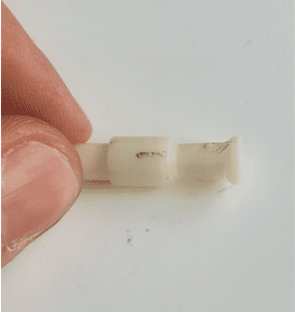

The first problem with cruise part of the switch was center stalk, you can see some spots on the narrow right side. Plastic deteriorated so that it was out of round causing cruise circuit to be open all the time. Sanding it down with some fine grit sanding paper was enough. Second issue was that somehow, on the cap, the copper rivet lost it's connection to the brass wire connector. Some soldering fixed that.
View attachment 479089View attachment 479090
