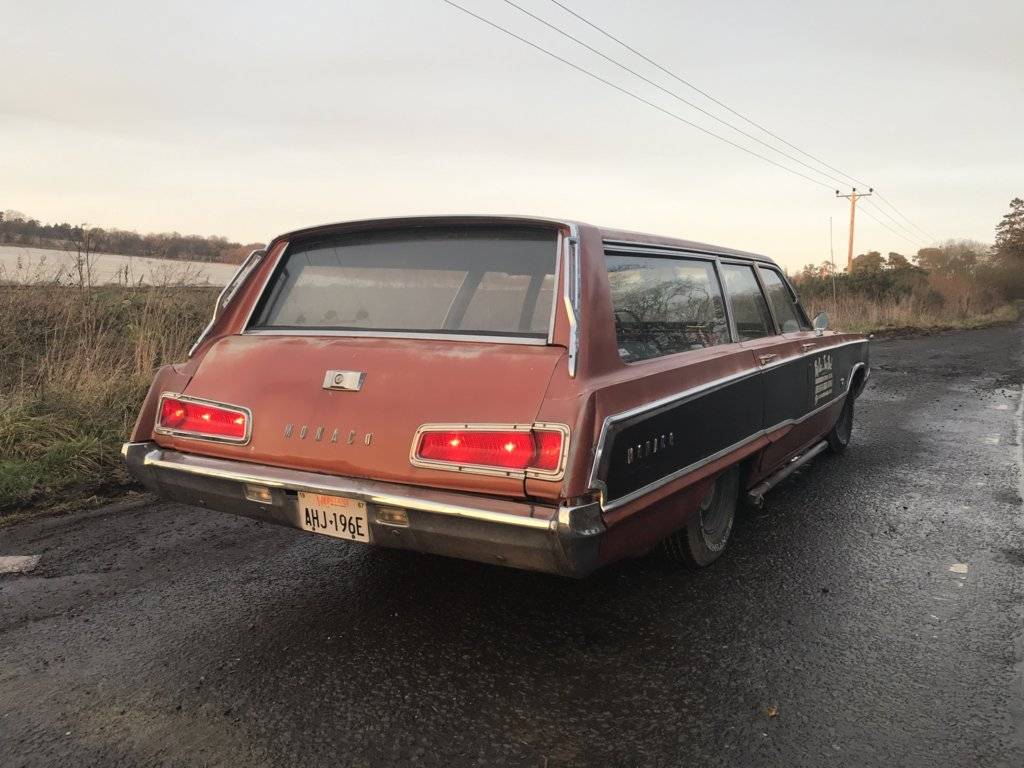

Suddenly, my brake lights have stopped working. 2 weeks at my very competent local garage & still no luck...
Could anybody please advise on all the things to check?
The switch looks like it disconnects rather than connects the circuit when you press the pedal, which is new to me & is connected to the turn signals somehow? Totally lost even with wiring diagrams! Any advice would be really appreciated as it’s a crazy thing for her to be off the road for!

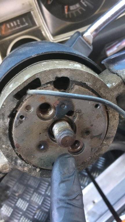

Thanks for this - going through give that a go & have a new old stock switch to replace it with as well. Totally stuck now though as steering wheel proving impossible to remove with a pulled & access is difficult because of the plastic shroud?
You need a puller to get the steering wheel off.

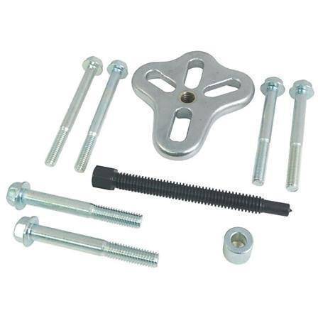

This is a proper steering wheel puller...
But I use one of these...it's tight to get the bolts in place but it works....
