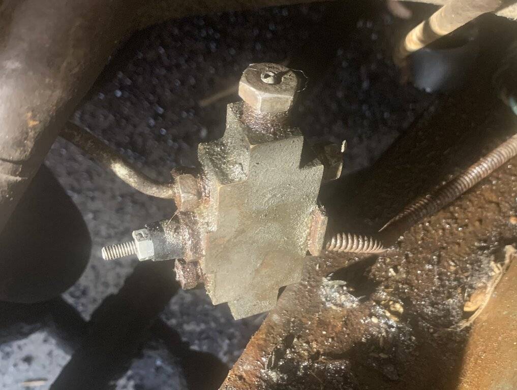

This is what I pulled out of my 68. It looks like a proportioning valve to me. I put it in a hydraulic tester and it wasn’t exhausting out of the rear outlet port.
That's a distribution block/safety switch and not a proportioning valve.
All it does is if you lose pressure on front or rear brakes, the pressure in the working side pushes a small piston up far enough to turn on a warning light. That, and provide a good place to split left to right, is all it does.
I suppose it could be gummed up and/or the piston could be stuck.
A cross section. I've never had one apart, but it looks like it could be taken apart easily. Also really not all that crazy expensive to replace.

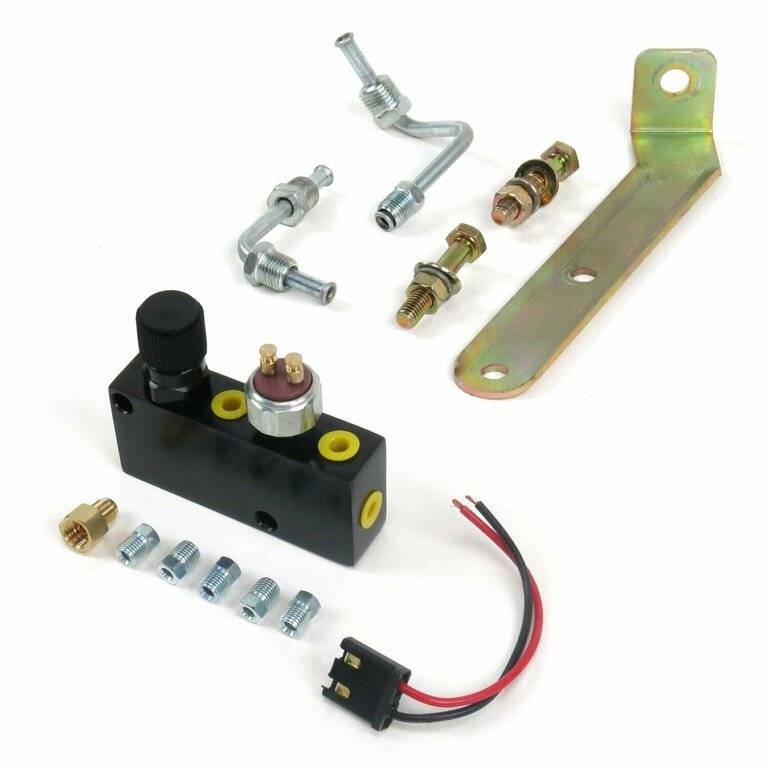

Upgrading my single pot master in the F100 to a dual master plus a power booster. Everybody asks about a proportioning valve but in a Ford it is a distribution valve with the brake warning light when four wheel drums. Now in my upgrade, since it is damn near impossible to find a decent distribution valve I will be using a proportioning valve under the master which came in an assembly kit. So I can adjust the pressure down in the rear since more braking effort comes from the front anyway.
Link, please. That setup looks great!
Got off ebay after a fellow F100 forum member showed it to me. Saved it to my list and the next day the seller emailed me a new price at $81.62. Right now it is awaiting installation as I am dealing with the rod between my master and power booster being too short despite adjusting. So that comes first.
Yes, I saw GM and ignored it since the person who referred it was reliable.
GM Disc/ Drum Brake Proportioning Valve Distribution Block Kit + Bracket & Line | eBay

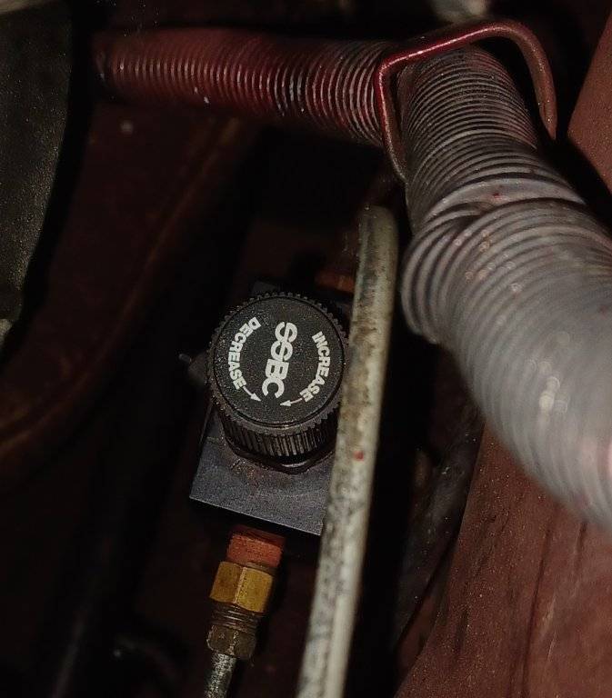

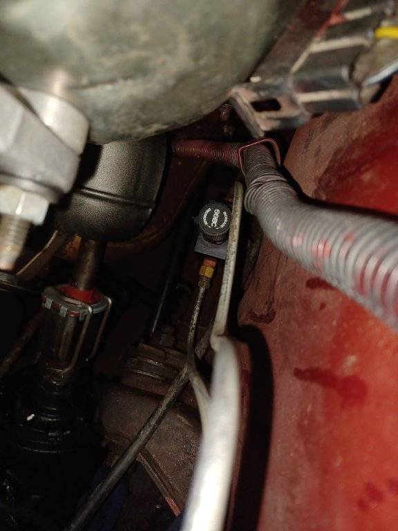

I'm a recent owner of a 66 Plymouth Fury that came with front disc and rear drum brakes with a SSBC proportioning valve (see attached pic). Since I am replacing the brake lines and all brake parts, I was curious if I should replace the proportioning valve. I have no clue if it works since I took the car out of commission a couple of days after buying it. Aside from leaving it installed and once I have everything connected, test it while making test runs with car, anyone have a suggestion as to how to test these on a bench? Blow thru it? :) Should I replace it and with what?
