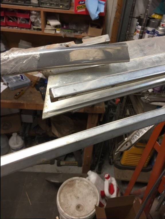

Starting to clean my trim for my 68 Polara. Initially I thought it was a combination of aluminum (beltline, wheel well, and bottom rocker) and Stainless (windshield, hood, windows, drip rail and rear window). However my magnetic screw driver is sticking to what I thought was stainless. Is it actually chromed metal. I didn't think stainless was typically magnetic. Anybody have the answer to what materials were used?
View attachment 96821 Starting to clean my trim for my 68 Polara. Initially I thought it was a combination of aluminum (beltline, wheel well, and bottom rocker) and Stainless (windshield, hood, windows, drip rail and rear window). However my magnetic screw driver is sticking to what I thought was stainless. Is it actually chromed metal. I didn't think stainless was typically magnetic. Anybody have the answer to what materials were used?
It's stainless.
It's a common mistake that all SS is non magnetic. It depends on the alloy.
The SS trim work on our cars is a alloy that is magnetic.

I buy my stuff from Caswell plating, but I started with an Eastwood kit. I also bought a Harbor Freight buffer and did all my trim on my 300. It's dirty work... Wear a dust mask, safety glasses and gloves. One other thing, once you get a good feel for doing it, get some larger diameter wheels. They are more apt to yank the piece from your hands, but they polish faster.
Thanks for the info
I bought a 1hp 10" dual wheel buffer and accessories from Eastwood.
Am working on the dings and dents now. I stumbled across a video on U-tube showing a guy using a Papa-dent tool with a mushroom head. I Had to have one. I have been practicing on a really rough piece of aluminum trim. I love it.
