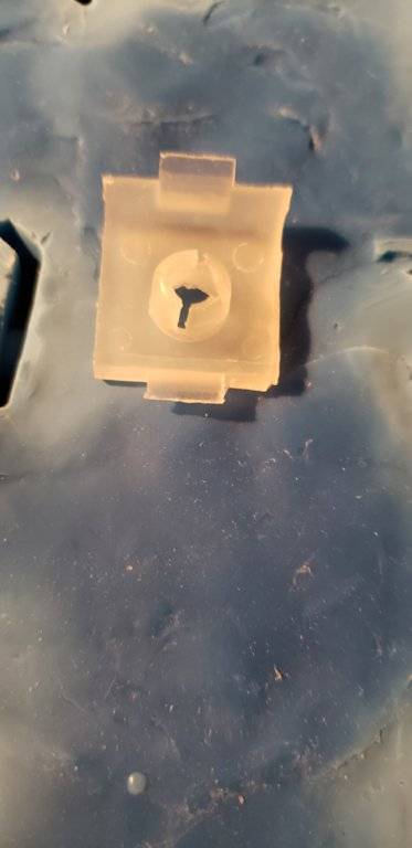

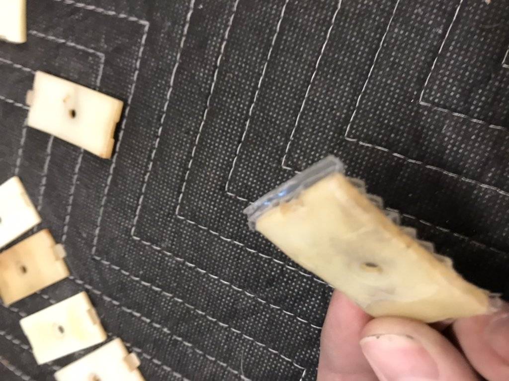

That’s part of the issue. I don’t have one perfect one. The other thing that is key. Is the very thin small backing tab that goes between the trim and body.
I think the tiny thin pad would be a bugger to mold consistently.
I have an idea to re- create the tab with the clear gorilla tape. That stuff is pretty amazing and has a long life span.
The clips themselves are usable and all there. 12 for each side. I just need to add anti rattle characteristics to them.

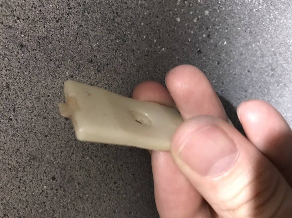

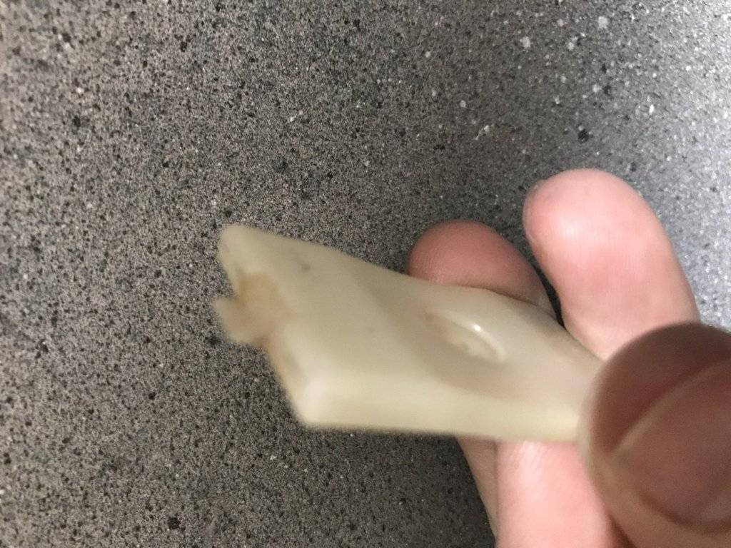

Here is a clip I made last week. The first clip mold I made, and like I mentioned, I have used it to make hundreds of them.

I saw those in your other posts. That’s exactly what I need. If I had some good ones. I would definitely send your way.
For now I think the gorilla tape may do it. It may also add a little extra gripping surface as my trim has been pounded around enough that I may need the little extra grip where the edge cuts in.

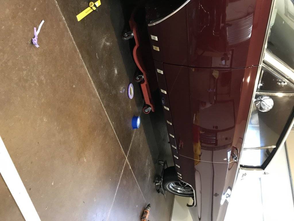

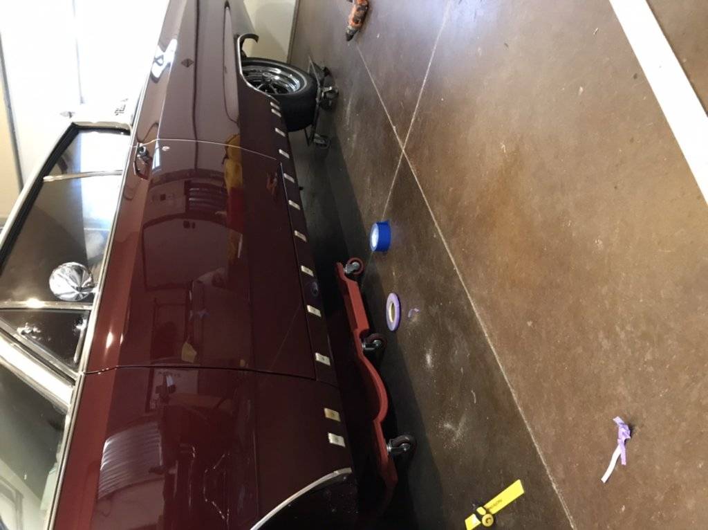

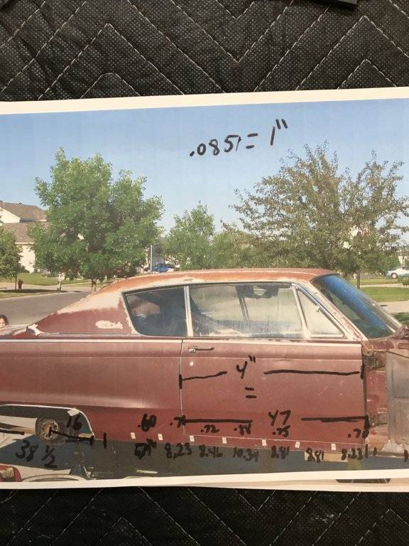

I found an old picture of my clips on. Tried to scale the picture. I found they are not evenly spaced. If I start 3” in they are 7” apart doing straight spacing. But in reality they must have had the first two a little closer together as my picture shows spacing a little over 8” and up to 10”. I probably want to have them closer together at the ends so they don’t come flying off.
Good luck finding your holes, you have your work cut out for yourself, but at least you found a reference picture.
The good thing is the portion of your clips which do all the work and keep you trim atteched appears to be in great shape.
With the irrational spacing I may give up on the original holes. With two pictures for reference I can only get within a 1/4” of each other. Quite a ways for a small drill.

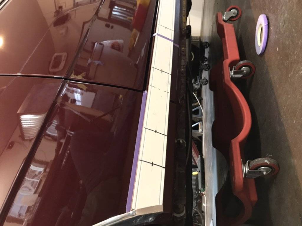

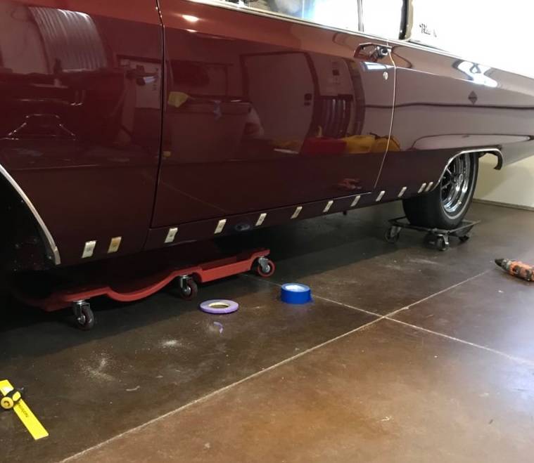

Ok have my layout spacing defined.
Front and rear edge 3” apart, then 6-1/4 twice to get past the front fender then 7-7/8” after until the rear with two 3” apart. Thought process more clips towards the front to handle air flow, then close towards the rear to prevent buffeting.

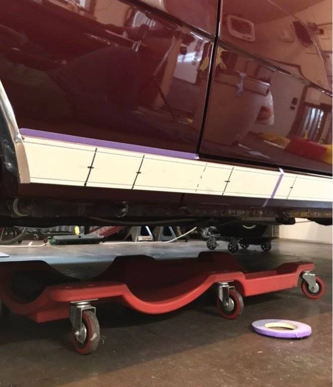

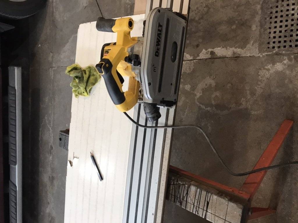

I made a template using my favorite tool.
It is a Track-Saw. It is great for sheet goods when you don’t have a panel saw.

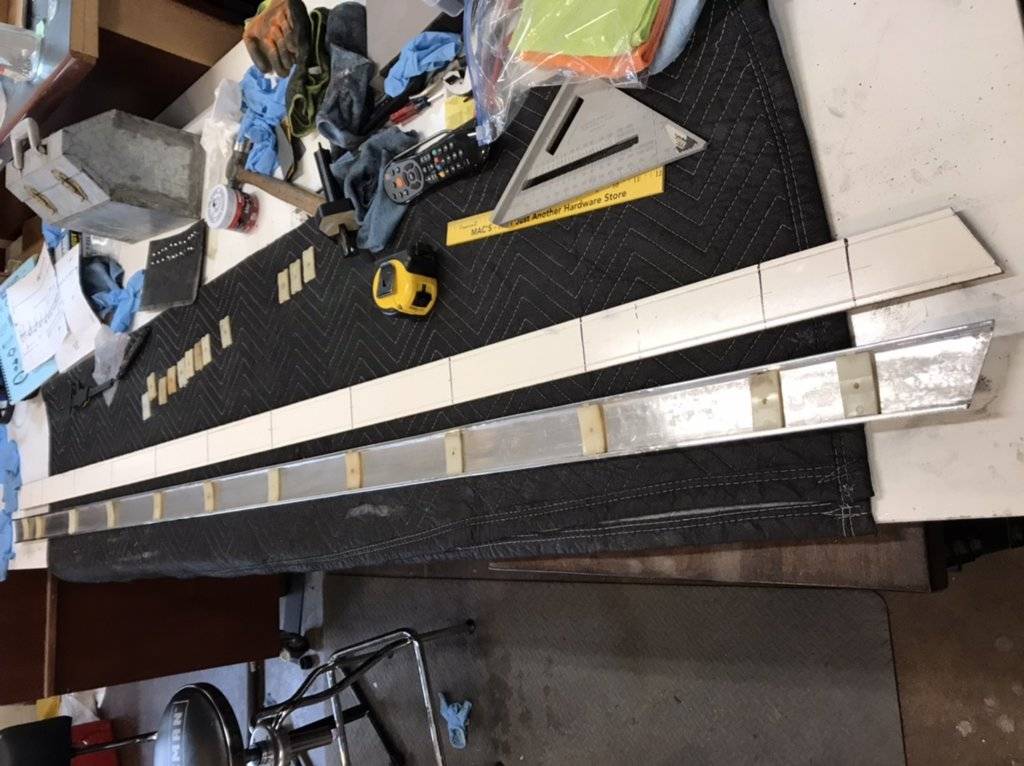

Anyway cut it to size, marked out the holes and drilled.
A little double sided tape on the back and some masking tape to hold firm, I am ready to drill. For the other side I just need to flip it over.
You know as I was laying out the template it did cross my mind that in a pinch a guy could jus do some chrome tape. Or a flat piece of stainless.

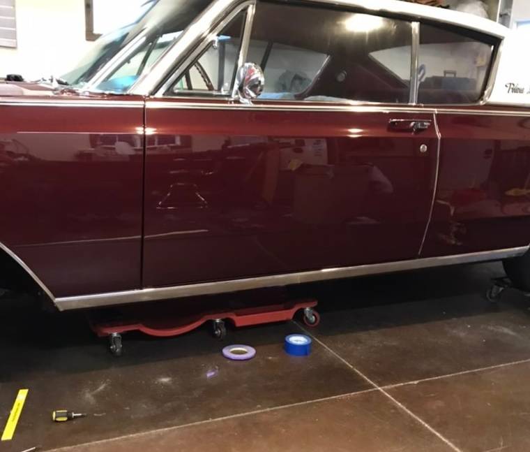

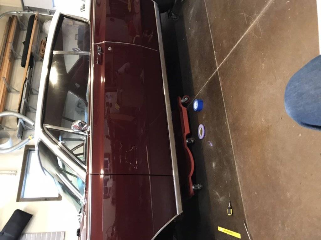

One side on. I did use some gorilla tape to make the tabs. I think It will work fine.
Let me try this picture again. The phone shows ok but rotates when I load it.
now it went the other way

I started out thinking simple template, but in the end this was easier and almost guaranteed to keep them straight.
