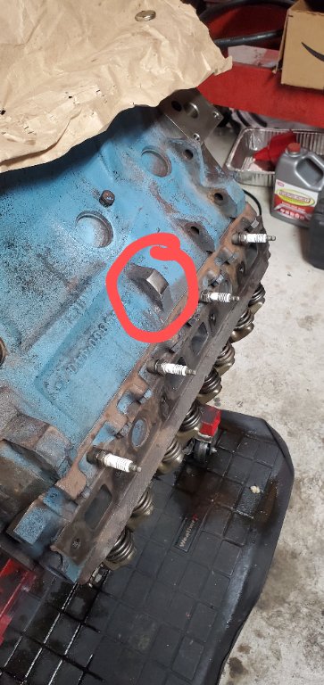

I am running a mini-starter (which works great) and my block is from an RV and there was a small "ear" on the block that I had to grind down. Not sure if this is the same for all blocks but it was in the way and it didn't seem to be necessary. I attached a picture of this for reference. I was working on an engine stand for fitment to the block but I installed the headers after the engine was installed back in the car.
