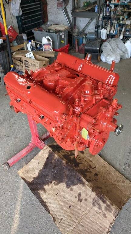

Soon to mate these two. And as Willie Nelson says On the road again ☺️

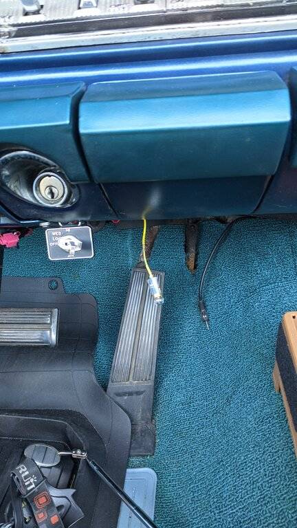

Can anyone tell me where this little bulb goes? 1968 Plymouth fury 3 I looked the best I could can't figure it out.
That would be for the ignition light. Yellow wire.
Bulb lights the blue ring around the ignition switch so at night you can see where to put in your key.

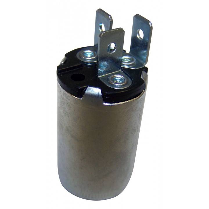

The socket is on the back of the switch/dash.

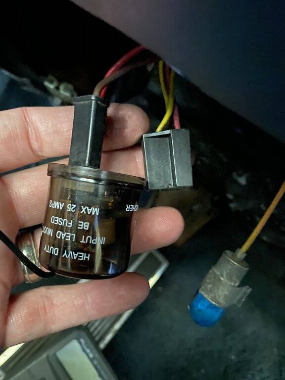

If the timer relay is still good it should light up when you open the door and stay on for a few seconds.
It looks like this and is usually in the dash wiring harness.
Is it still possible to purchase them,
I think I found this connector a couple of weeks ago. It was empty, thought it was a flasher connector at first, but quickly realized the spades were not the right orientation. Would love to see if it would work in my ride. (‘68 300)
