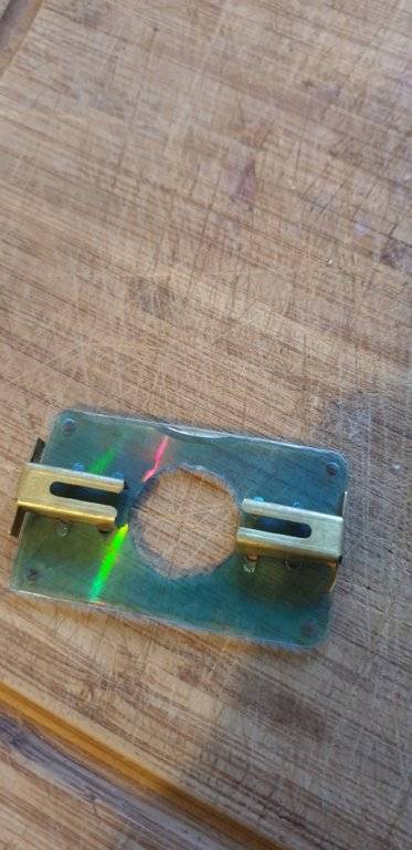

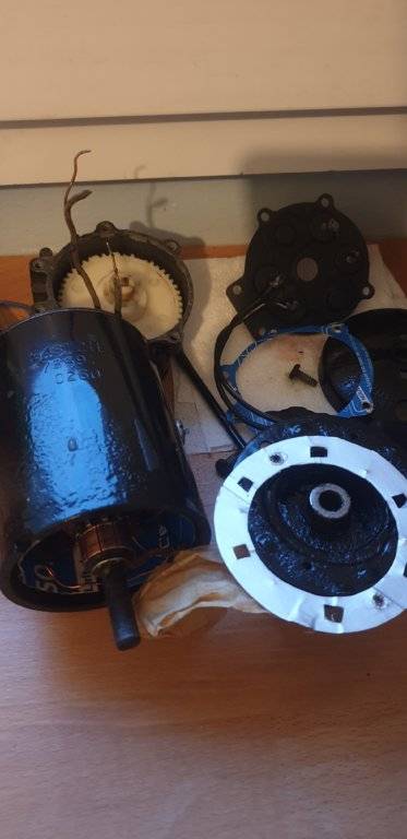

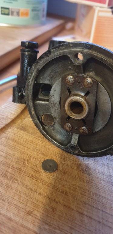

So I rebuild the headlight motor using a milk bottle to make the gaskets and an ols cd ot make the plate... :)
I found this tiny piece and do not know where it goes.. can someone help me ?

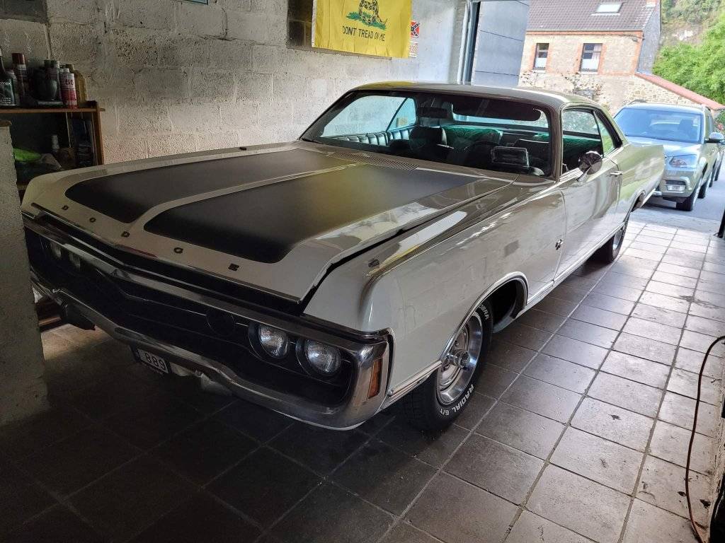

I have a 68 corvette and i still have the 70 monaco.
the monaco will move in belgium to a friend.
so the week end i did some work on it to be road ready.

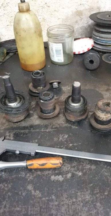

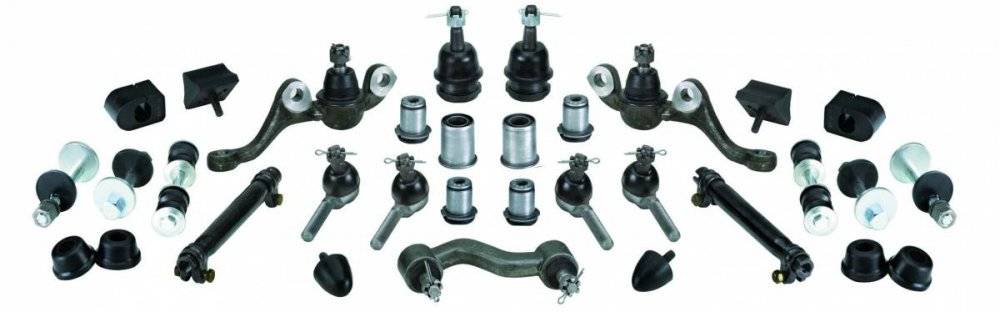

i bought a PST kit yeeaars ago for it :
Perfect kit, everything match.
to be fair, if you have the right tools it is kit easy and fun to do. It went perfectly well.

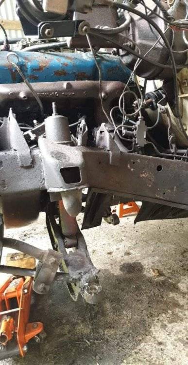

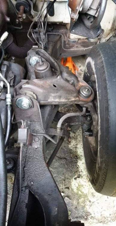

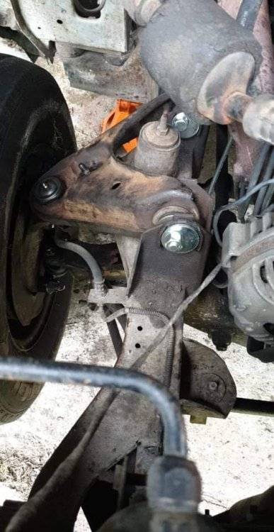

With the proper tools we removed the front end in 2/3 hours.
The only bushing we didn't do are the lower arm ones because of lack of time and incertitude for the removal of the torsion bars. but they still are to be done.

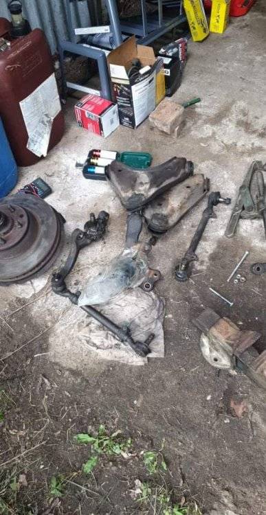

quite everything is here :

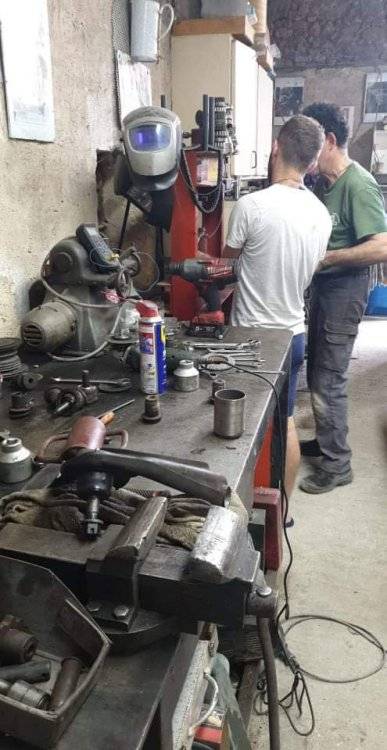

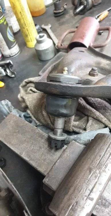

went to a friend for removal : it can be done with hammer but for the ball joint it is better with a press. We removed the upper bushing and put them back just with a hammer.
old ones :
took back on the car, it is quite easy too. And then a brief setting to be good.

i still have the 70 monaco. the monaco will move in belgium to a friend.

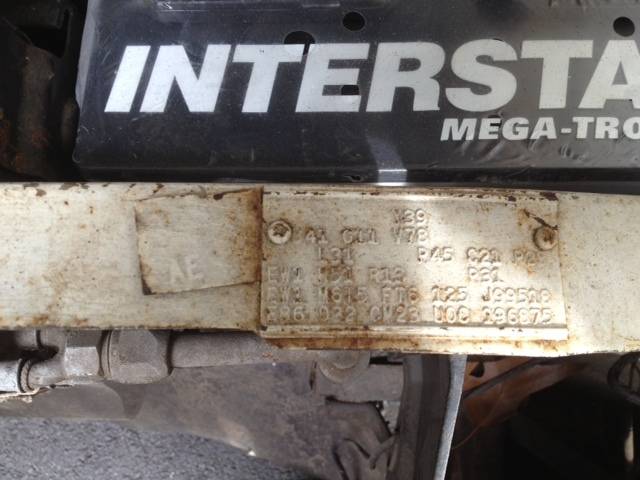

Sorry to hear that the Monaco will be gone, but at least it is going to a friend of yours. If you have more photos to post, including ideally the fender tag (PhotoBucket lost in in the "for sale" threads from Oct. 2015 and Jan. 2016), that'd be great!

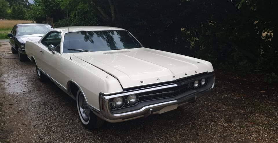

Hi, monaco is gone and not gone at the same time. It is always a bit complicated with me.
Car is at a friend's in belgium and very very well cared. It is a resurrection.
Lately we are searching for instrument cluster ( or at least fuel and temp gauge that are broken ).
Electricity ill be the next step next year.
My friend wants to buy it but for kiw he has the car to enjoy and use as of it was her.
He kind of customise it a little but do not worry nothing easily removable, i am very clear with that : a valuable car is a matching, original car. And if modified, keep original parts and nothing permanent.
