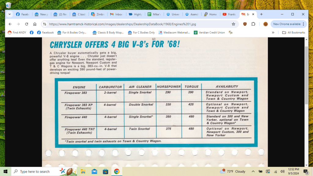

In one respect, if the 383 2bbl is "normal performance" either of the 383 4bbls would be "High Performance", I guess.
When the 256/260 cam debuted with the then-new 440/350 of 1966, the 383/325 was then-termed "Standard Cam", as was the 440/350. Both with the 256/260 cam. The then-new 440/375 HP engine used the 268/284 cam, with upswept HP manifolds. The first use of both items. The 440/375 also had 1.74" exhaust valves on the closed chamber heads, pre-906 a year later. Again, first use in those years.
There was also a "440TNT" 440/365 option on C-body cars in 1966. Allegedly "Twin Snorkels and Twin Exhausts", on most models of Chryslers. Same 256/260 cam.
When the 1968 Road Runner arrived, with the 383/335 engine, it had the 440 HP cam, exhaust valves, heads, and exhaust manifolds, which advertising mentioned as "street cred" items. Windage tray, too. Aided by an unsilenced, incognito open element, air cleaner.
ALL 1968-71 B/RB engines, including the 383 2bbl, got 906 heads and 1.74" exhaust valves, standard equipment. As the 1968 383 4bbl Standard Cam motor was still 325 horsepower, yet the 383 2bbl jumped from 270 to 290 advertised horsepower for 1968.

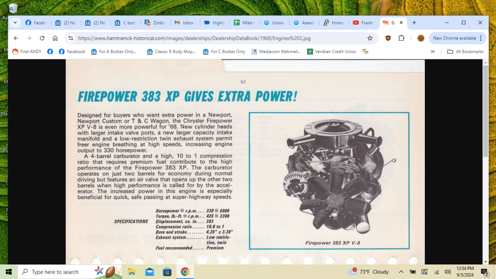

Great write up as usual but don’t forget about the head in between the 906 & 452, the 346.

In 1966, the 383 2bbl cam was the 252/252/.390" cam, with the 383 4bbl having the 256/260/.425" intake .431" exh lifts (I believe). That 4bbl cam was also termed "Standard Cam" in sales literature. In 1967 or 1968, that cam was also used in the 383 2bbls. The 256/260 cam was NOT a wild cam by any means, just a bit better than what came before it, but had little power increases over the earlier cam, as to factory ratings.

As stated above, the applications change over time. This is documented (not 'some guy says', not 'I saw it online', not 'I read it 30 years ago in a magazine', not faded memories) but current research based factory documentation from broadcast sheets and Lynch Road fender tags.
A 68 Charger did not get the 335 horse assembly.
A 69 Charger, or any B body, with a four speed and no a/c got the 335 horse.
We have documentation via a BS of a 70 Charger with a/c getting a 335 horse assembly.
There is no 335 horse a/c assembly until 70 so you friend could not have had a 335 horse a/c car in '69.
I have spent the better part of 20 years researching this topic and compiling the documentation..
VIN codes and sales codes are irrelevant to which assembly the car received. ALL 68-70 383-4 cars code H/N in the VIN but not all H/N code cars are HP. What matters is the Body style (A, B, E or C body) the transmission and whether the car got a/c or not. A 383-4 in a 68 Dart is different than in a 68 Charger, both are different than a '68 Super Bee and all three are different than a '68 Monaco.
