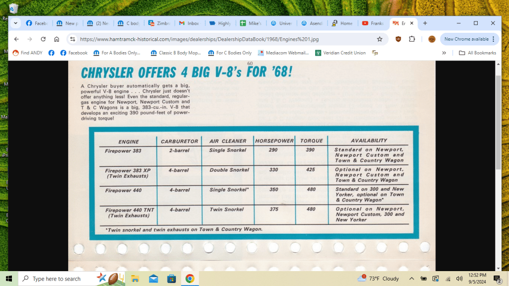

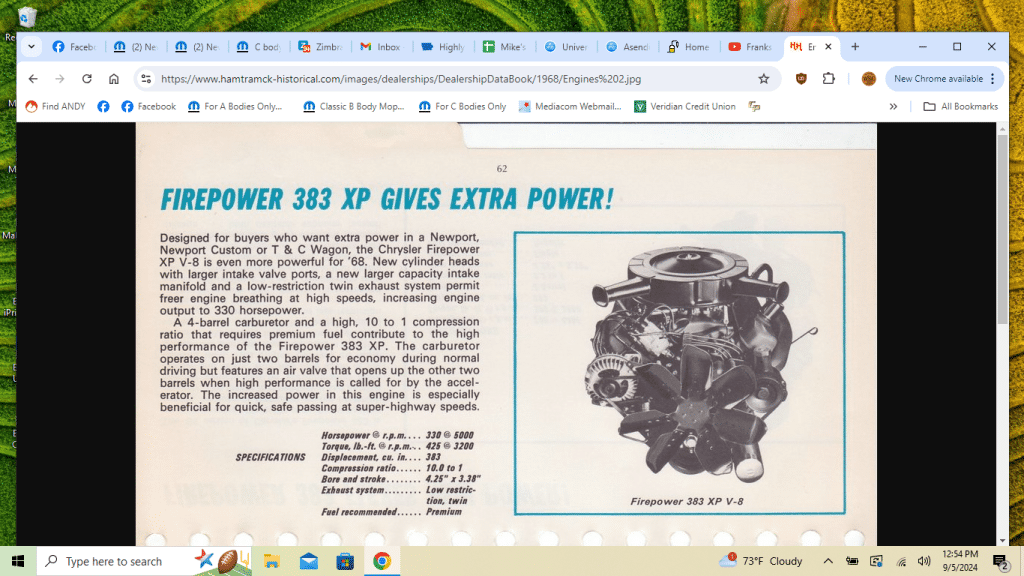

I found the a/c exceptions listed for 1969, but Dodge was more open about it than Plymouth in the Data Books. Didn't find similar in 1968 Plymouth Data Book, just the exception of factory a/c not allowed on 383 2bbl 4-spd B-bodies and GTX 4-spds. Nothing on 383 4bbls noted. AND nothing about it listed in the Plymouth sales brochures.
What I did notice in the Plymouth literature was an engine listing for 1968, which listed the camshaft versions. The 383/330 was termed "Special" (as was the 383/290 2bbl) and the 383/335 was termed "High Performance", plus other words like "high lift, long duration" for the 383/335 cam. Which equated to the "Special" cam being the 256/260 item and the "High Performance" cam being the 268/284 item.
So, my knowledge expanded,
Thanks,
CBODY67

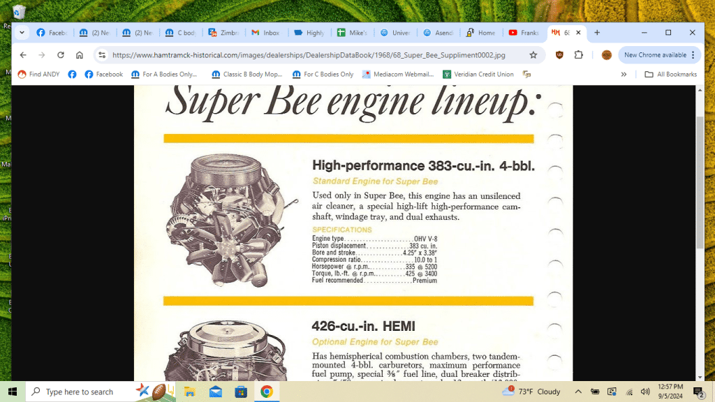

Most of the HP engines had some kind of air induction in the hood. They couldn't fit a V2 and that big air cleaner in the same space. Here's a page out of the 68 Chrysler book and the 68 Dodge (SuperBee) book. The specs look the same between the 2 divisions. View attachment 680596View attachment 680597View attachment 680598
I knew about the a/c restrictions related to the cool air induction systems, plus 440 6bbls and HEMIs. That big RV2 compressor got in the way.

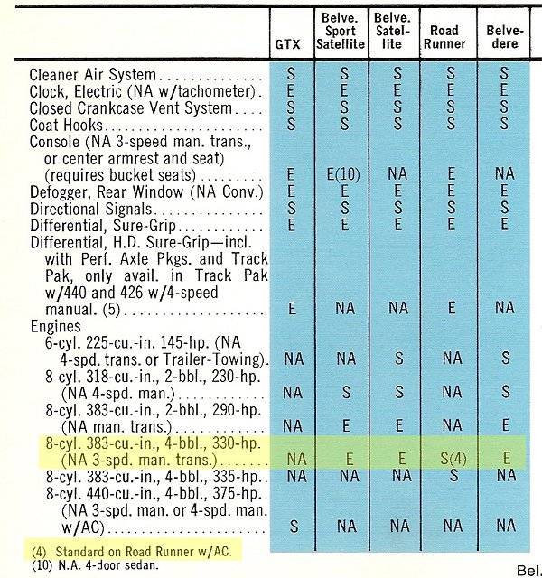

Power windows would have been available on a 68 RR hard top. That would be irrelevant to which engine assembly the car received.
You could order A/C with a Road Runner but you would get the 330 horse assembly in 68 and 69. The change to a 330 horse assembly is listed in the 69 data book. I'm not as familiar with any notification in 68. It could be there....
Yes, I found the page ref'd above. Found no such page on Hamtramck Historical for 1968, for some reason. On the Engines page of the 1969 Dodge Coronet data book, it plainly said the 383/330 was for a/c cars, rather than the 383/335. As I mentioned, Dodge was more open with that information. Back then, that would have meant nothing to us as to what was in the motor, as to camshaft.

I concur, a rated 383/335 never made it into a C-body. Only the 383/330 and prior 383/325 and prior 383/315 did.
