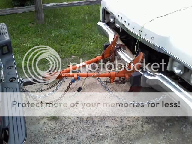

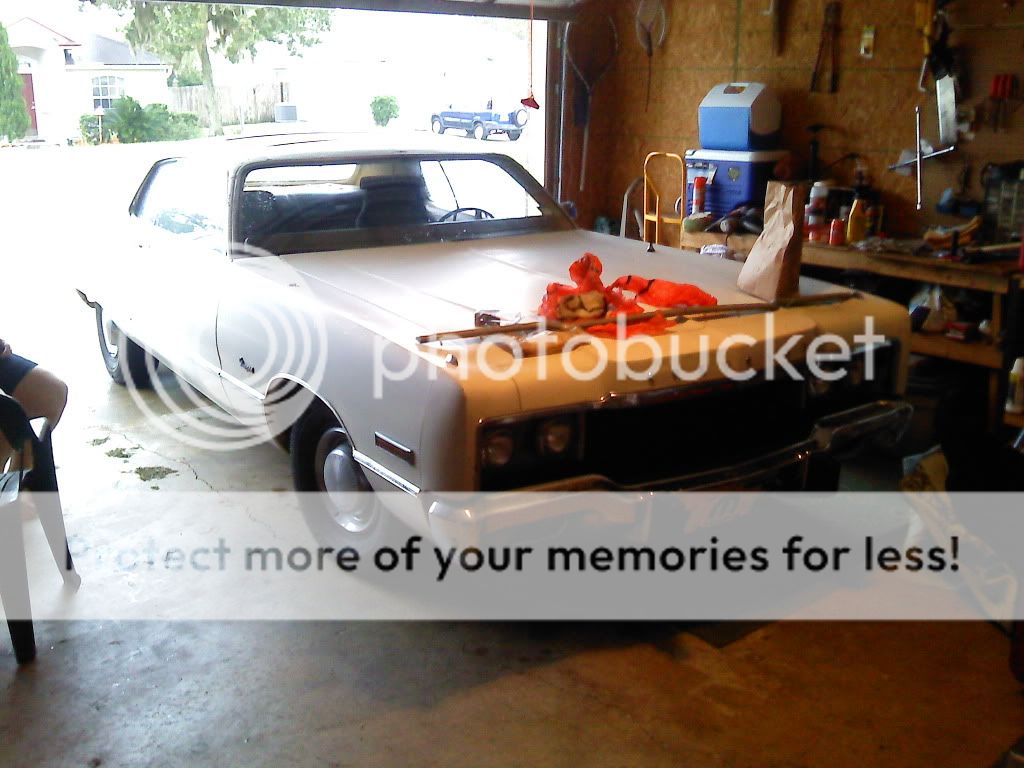

Finally made it up here. Got to see the old girl! She fired right up after a oil change, and battery charge. Put some air in the tire's, a bath, and we have been cruising around the past week.
So were gonna see how this goes, Got a different bar from a buddy, that is straight from the '70's. Hooks right up to the bumper, and bottom frame area. I did have to remove the front grill, and trim for the hooks. Took it for a little drive, and she seems to track great. A little fun going around sharp corner's, but I think it will be fine once on the highway. I did loose one of the little hooks on the test drive, gotta see if I can find one before we leave.

I have seen people use bungee cords between the steering wheel and doors to keep the steering centered and avoid oscillations. That works best on the highway where you won't make sharp turns. You should remove in parking lots so the following vehicle's wheels can follow and not scuff.

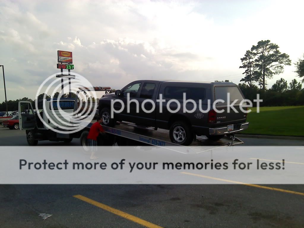

Well...... the last few days have been fun... NOT!!! Lady luck was not much on my side. We left friday at 10pm, drove ohio, and kentucky during the night, and made it to TN early morning. I pulled off onto one of the very first exits in TN. This is where it all started. Getting back on the highway, from the on ramp, and 3/4 more miles was nothing but straight up hill. By the time we reached the top the truck was running pretty hot, pulled over and let her cool down. Drove her a little while longer and she was still getting hot. It got to the point where I would have to drive up a hill, shut the truck off, coast down the hill and let it cool, then start it back up and drive up the next one, and so on.. Made several stops for coolant, and water. We got to a rest stop right into Georgia, and let her sit a few hours. I figured "well maybe if we let her cool down completly, then she might be good to go." We got back on the highway, and withing 1.5 miles she went straight to hot from dead cold. This is when I knew I was in trouble. I took the Thermostat out, flushed the system checked the fan yada,yada,yada. It seems Ive either blown a head gasket, and or cracked a head, or there is a very slim chance the water pump is out, but I dont think it is..
Had a wrecker come get her, and into the newport we went! This scared me alot, as the car has NEVER driven more then 30/40 miles away from home, and that was years ago, she has been just sitting the last couple years.. There was still 400 miles left to go, But she made it!! It was a long ride, as we traveled at 50-60 mph with the 4.10 gears. But she did it gracefully! It was a big joe dirt moment as half the front of the car was apart for the tow bar, and the trunk lid wide open with stuff cramed in it.

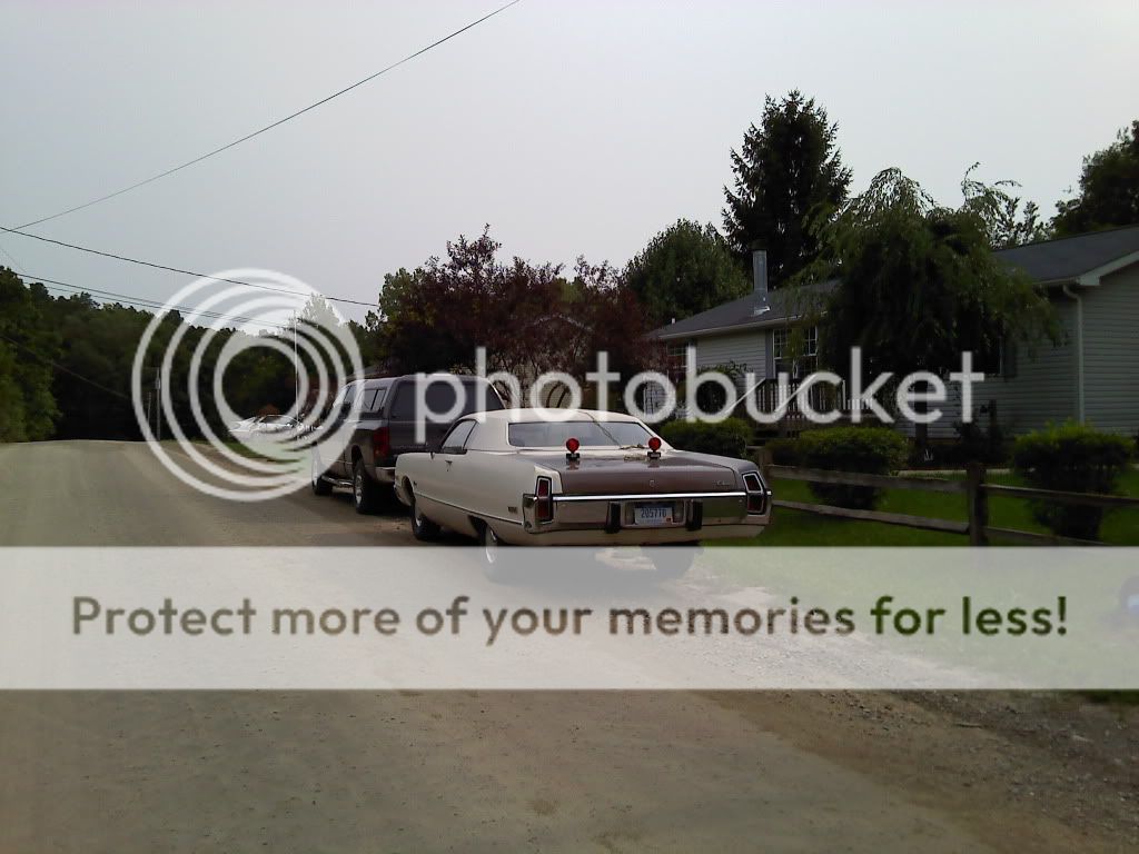

Here she is once we got home 32 hours after leaving MI.

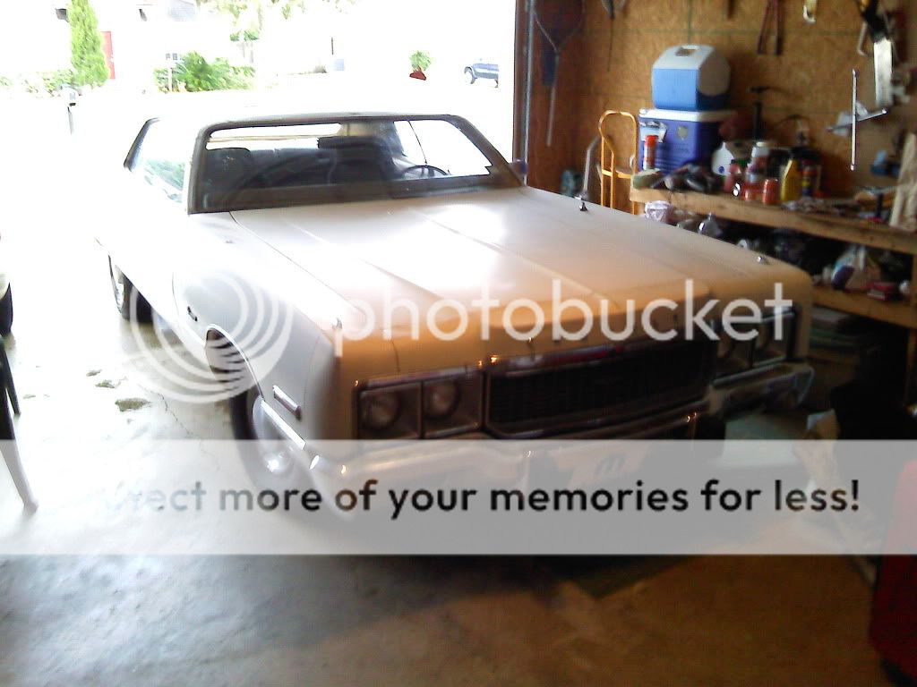

After i got her all put back together.
