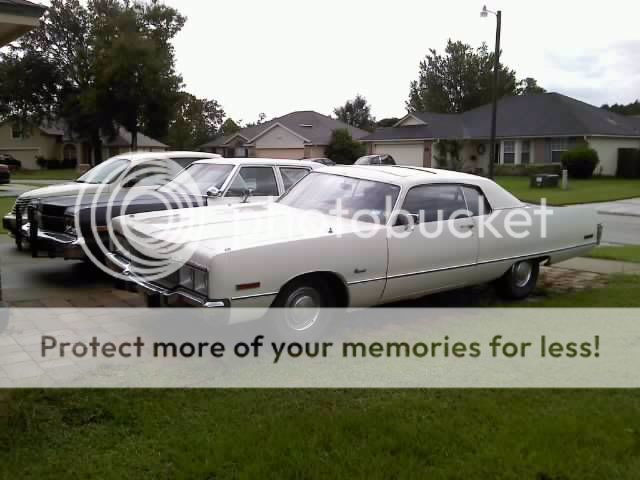

C body on a tow bar

At that point, I might have used the C body to tow the truck on a tow dolly. Its engine and tranny are sure up to it, but you would want a lot of weight in the trunk to keep the rear wheels planted.

If my newport had a hitch on it, I deff would of been trying to bring the truck home with it, but I don't think the tow bar I had would have worked with it.. Would of had to get a dolly or something.

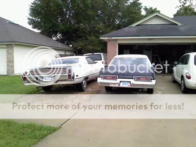

One good thing outa it, is the cars are back together!
