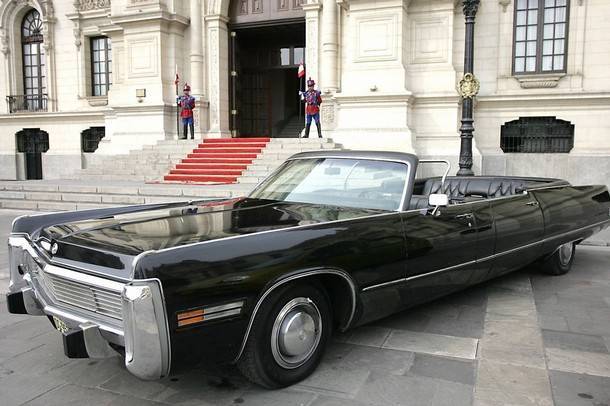

There's a guy on facebook who chopped the top off of a 69 Imperial coupe.....
Yet another reason to hate Facebook.
Found it, if you meant this one?! Seems to be a donor car.
I only know this one.
