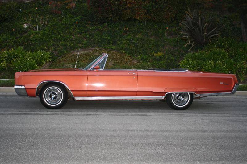

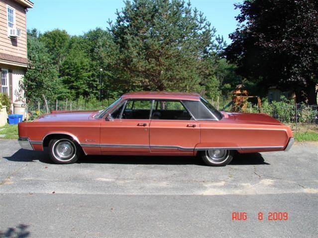

I found these two pics of a Newport on the internet.Anyone good with photoshop? How about grafting that four door roof onto that convertible to make it a two door formal roofline coupe ( ala Imperial Coupe)? 67ChryslerNewport-003.jpg1967 Chrysler Newport Four Door Hardtop.jpg
Just out of curiosity,I was wondering if there is any difference in the body structure between a coupe and convertible,specifically a 1967-68 body style. I'm assuming that the convertible body was stamped with more reinforcement to the body structure but does anyone know the differences? And why didn't Chrysler ever make a convertible New Yorker in 1967,when they had a Newport and 300 available?

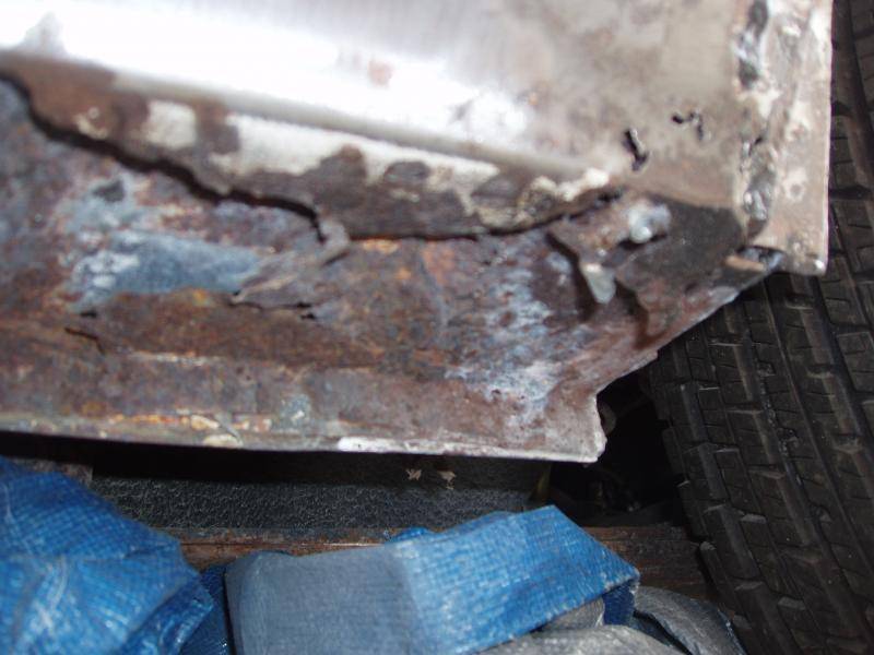

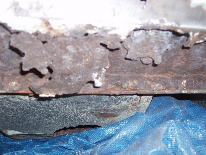

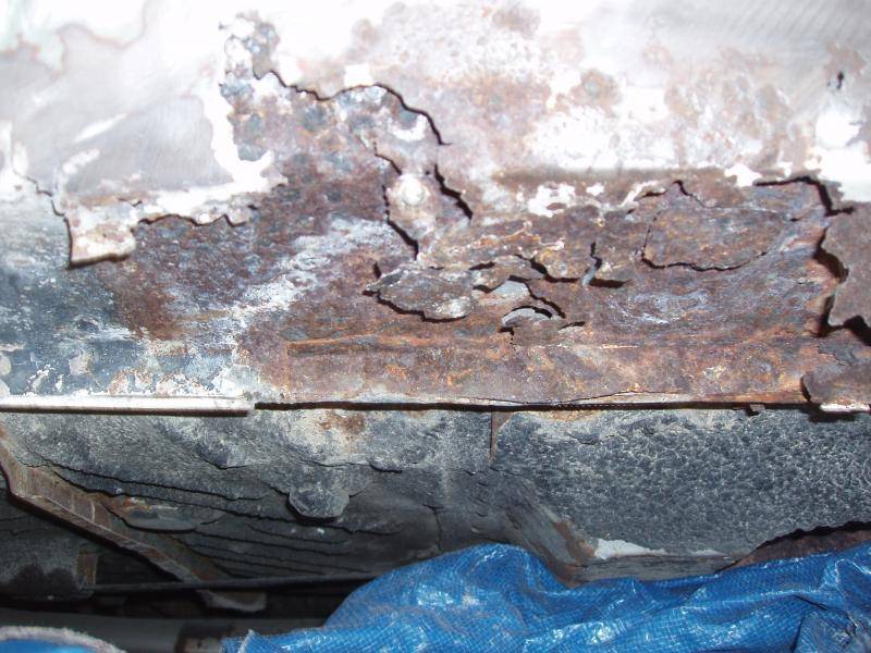

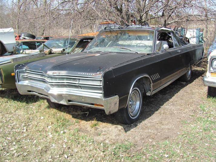

Here again... $800 without the wheels. Needs 2 floor pans and some quarter work as far as rust goes.
I will stand corrected, I have been informed that the rockers, among other parts were stamped out of heavier gauge metal for the convertibles and likely all convertibles.Thanks CLover! I will never stop learning.

That's the one. I don't know the gentleman but I just joined the Imperial group on facebook & he's there. He says that he intends to complete it...
He also has several other 69 Imps.
Found the group! I hope he will complete the car! Not many left of them...

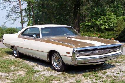

The 69-70 Chrysler convertible used a different quarter panel than the 2 Dr hardtop. Where the body line kicks up by the rear side glass is a lot shorter on the convertible. On the Coupe (this line was two-toned on the Hurst) it kicks up behind the side glass.
That looks like a conversion of a Chrysler Newport or 300 convertible into an Imperial, not a chop job. You can see the convertible top mechanism and that he's swapping over the Imperial sheet metal. Ought to look great when it's done.
I asked him for some details & I'll let you know.
