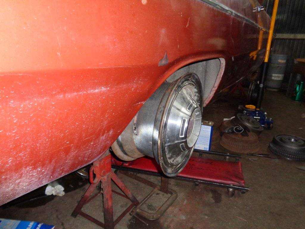

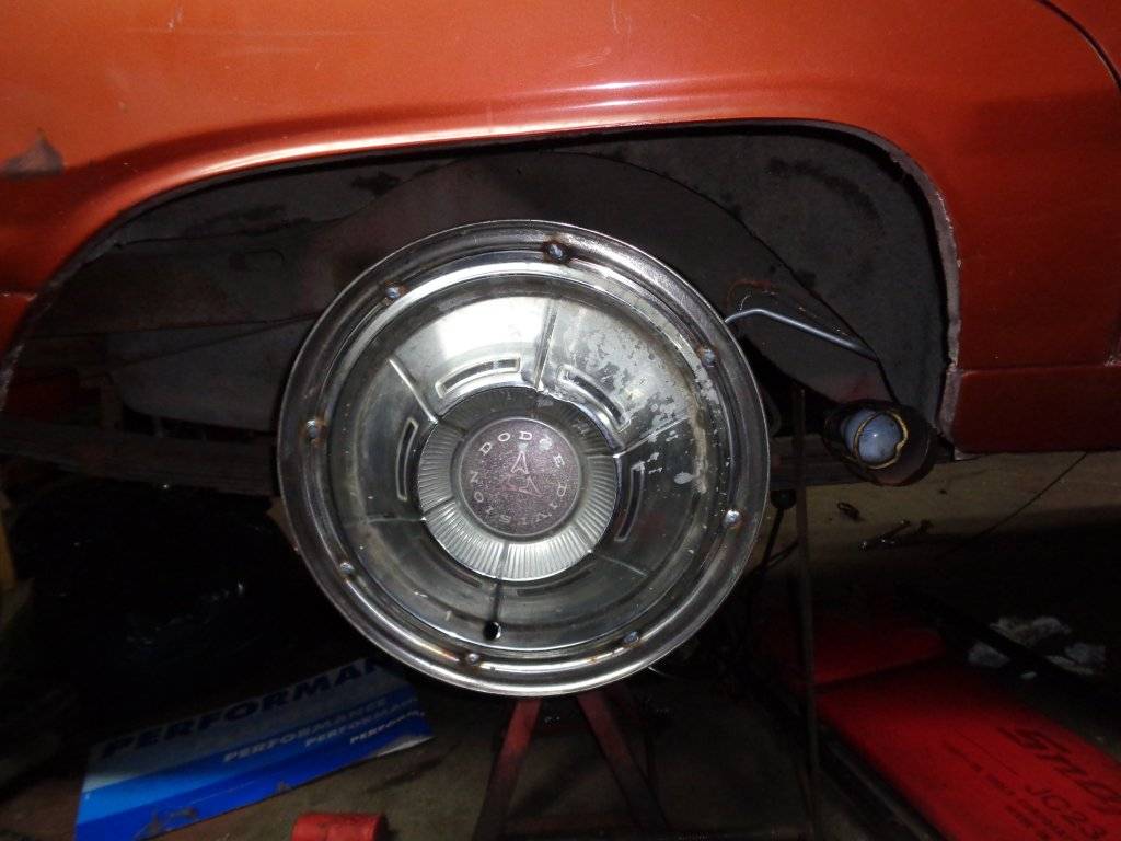

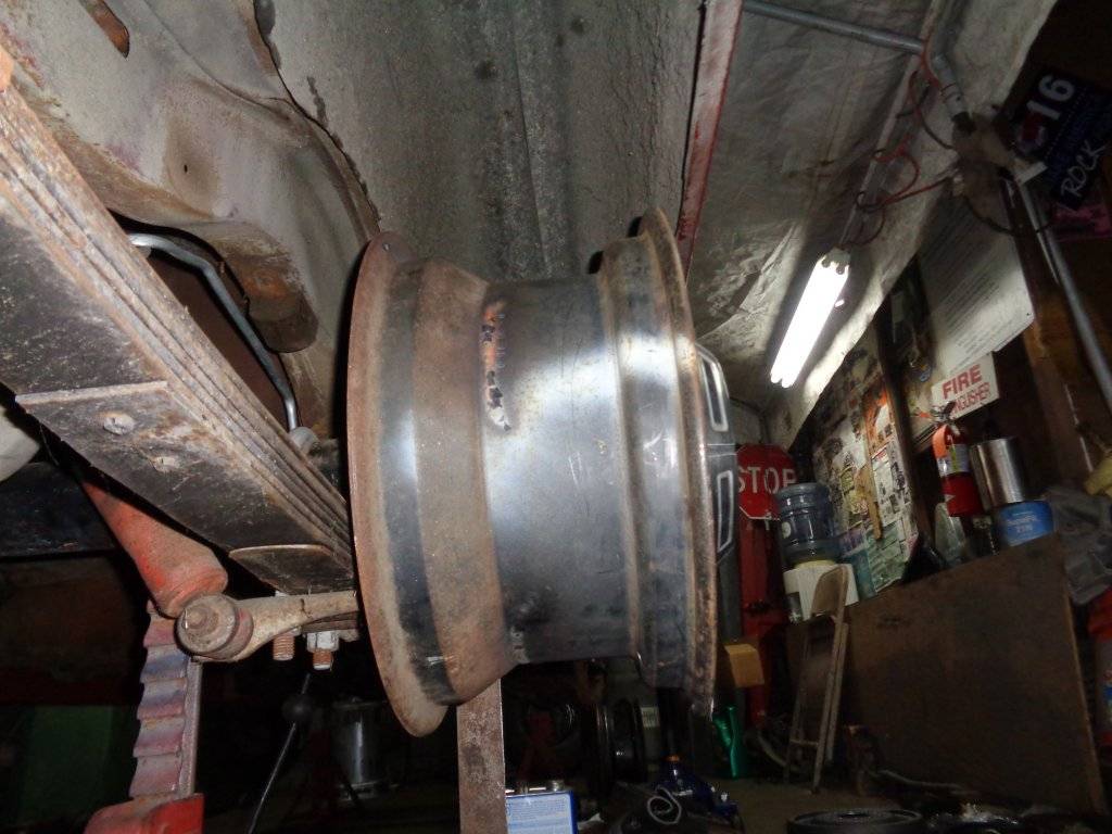

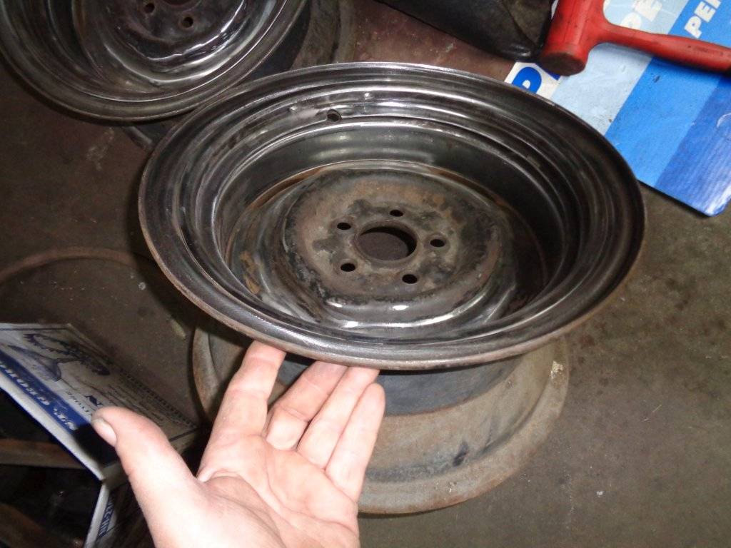

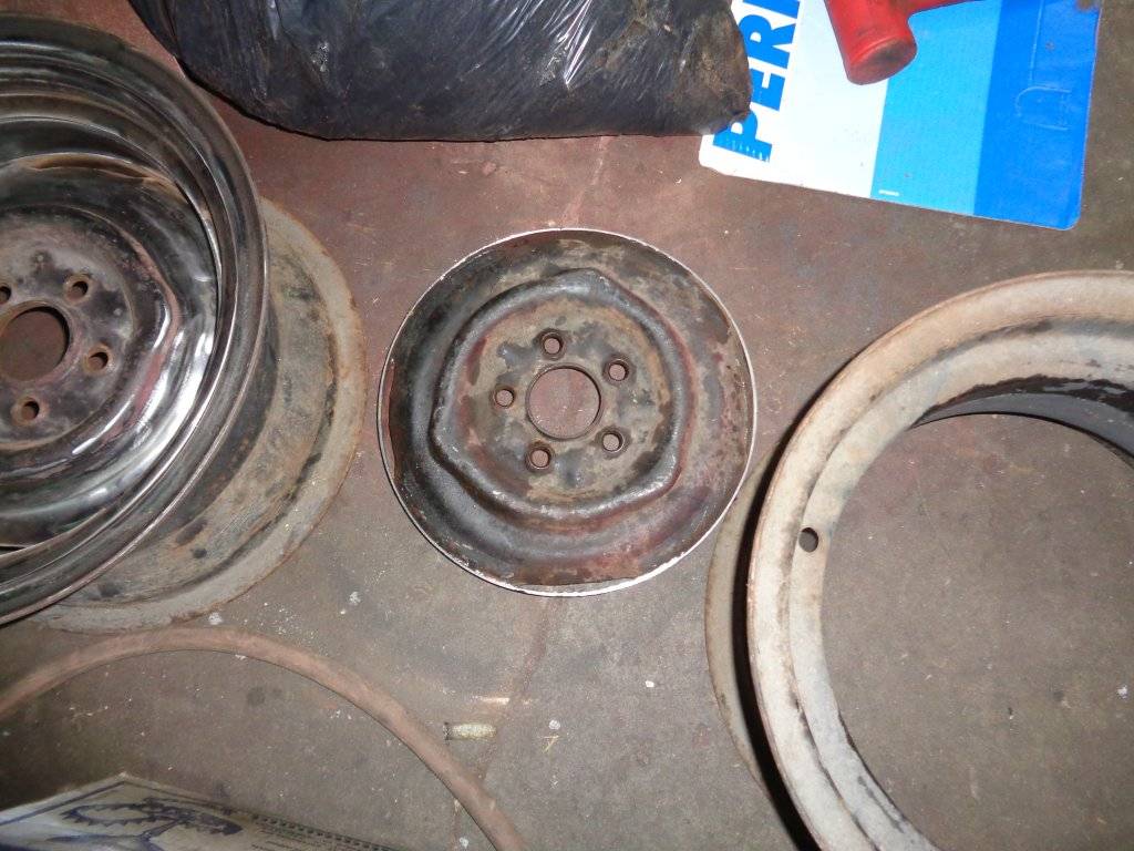

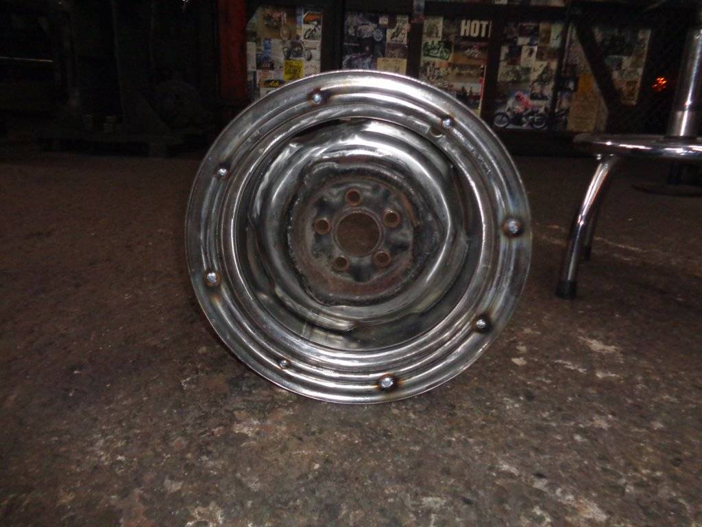

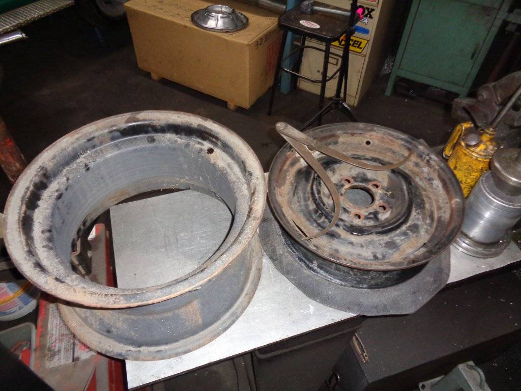

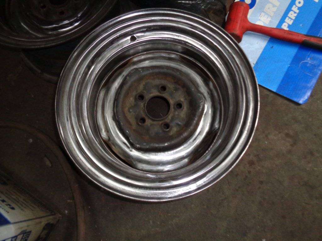

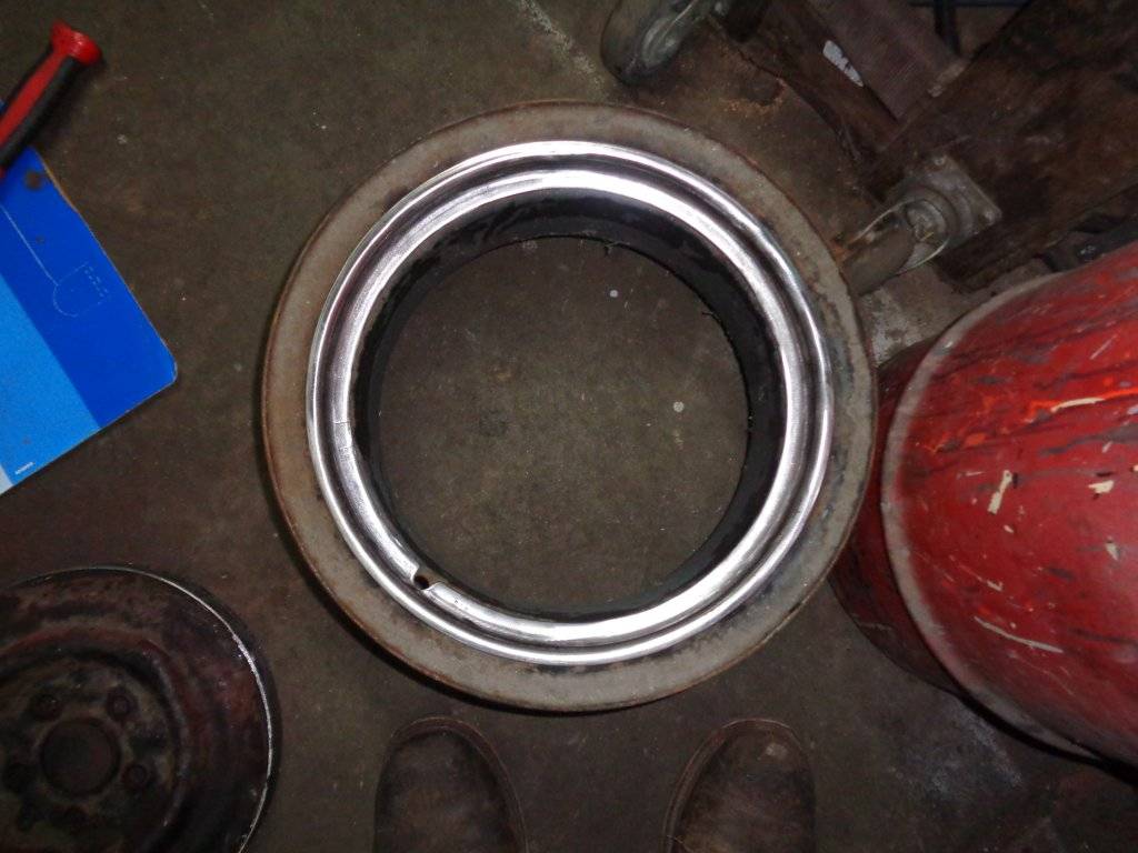

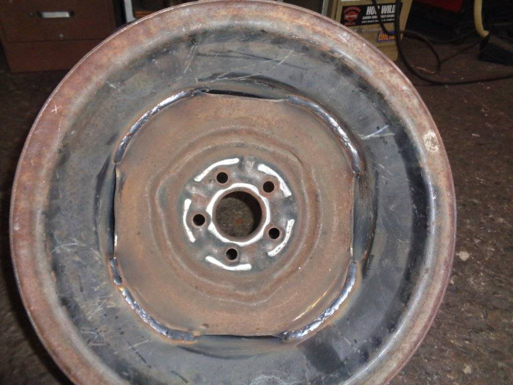

i've made some rims for a dart , using the 14 centers in a 15 outer band , and than added the part of the 124 rim that holds the wheel cover to the 15 outer . we didn't weld it up totally it needs air gap for water and what not tobe free to come out of that band welded on . and of course these where made for a dart , but thats just more room on other bodies , these are 15x8 bands on a 14 rim center .
I think I understand. Thank you!
my 15x8 bands where purchased from a wheel guy making 15's from 14's . just using the centers from the 14's in these special 15x8 outer bands . these 15 inch bands have a reduced center dia specially for this mod . not sure if these outers can be had anymore . i had bought all he had . he ha d some 15x7's as well ones but they all sold he said .
