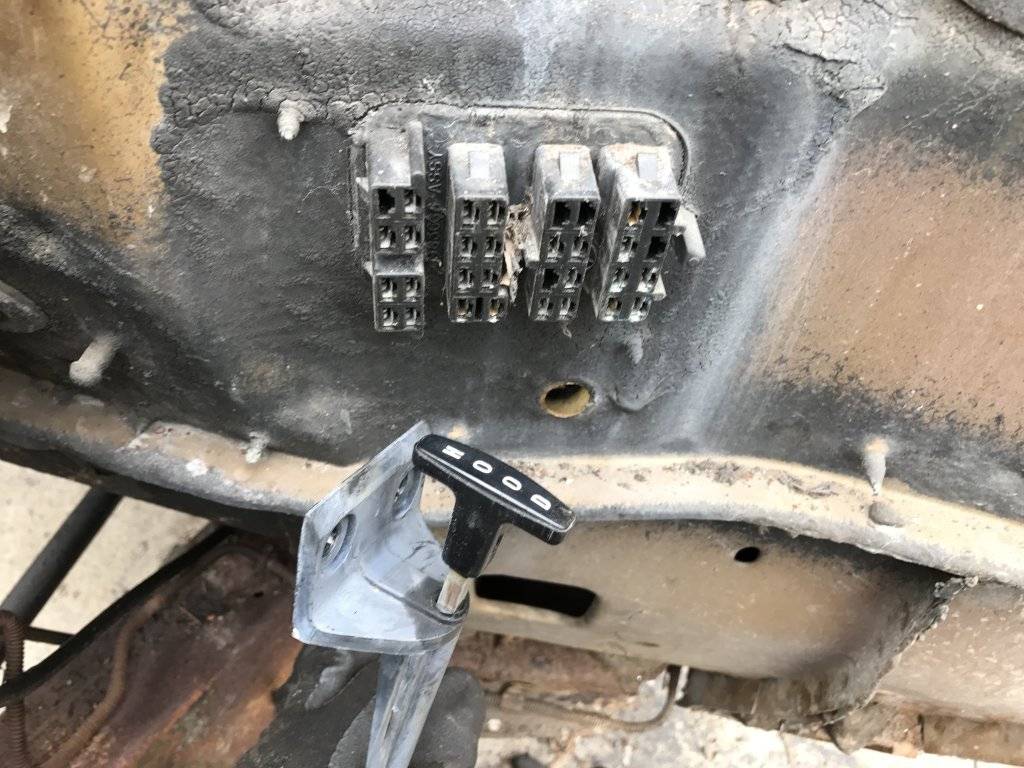

I specifically took this pic of the ‘73 firewall so I could remember where the cable would go in my ‘70. That’s the hole just under the bulk head connector. Hope that helps.
Oh, and there is a dimple there. :)

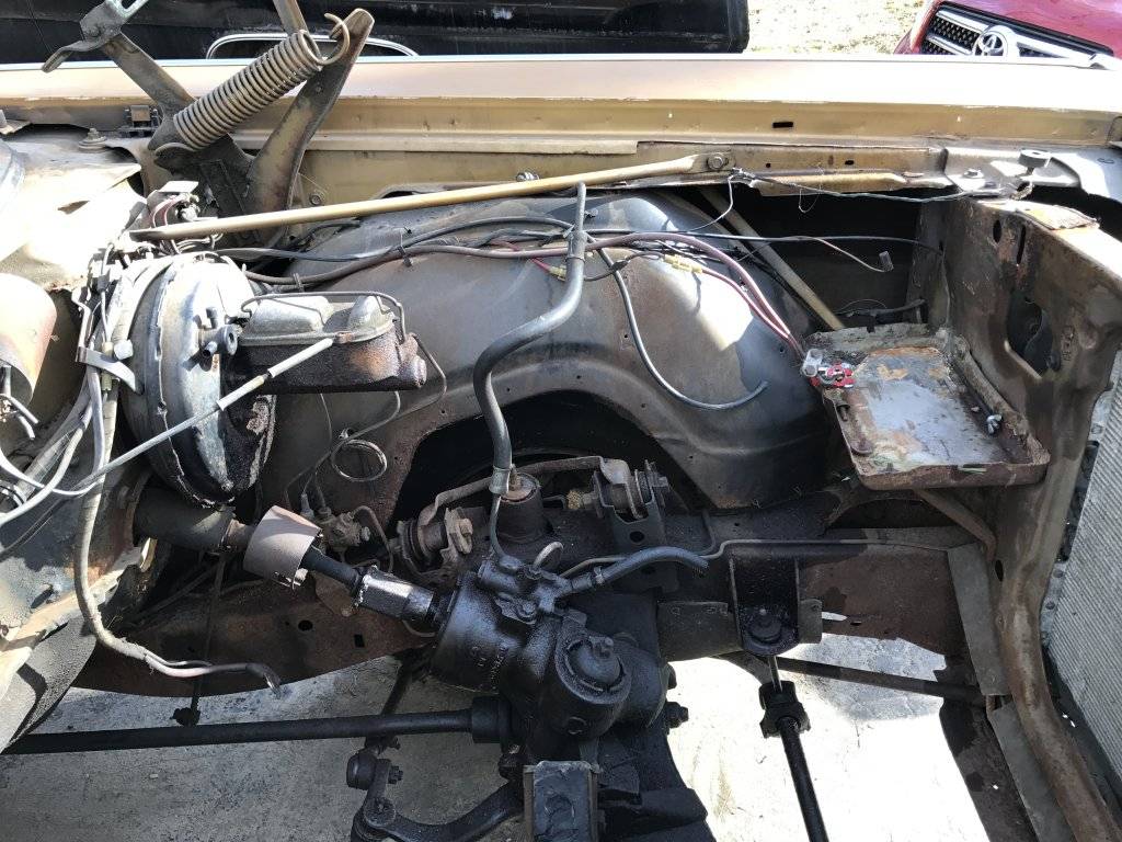

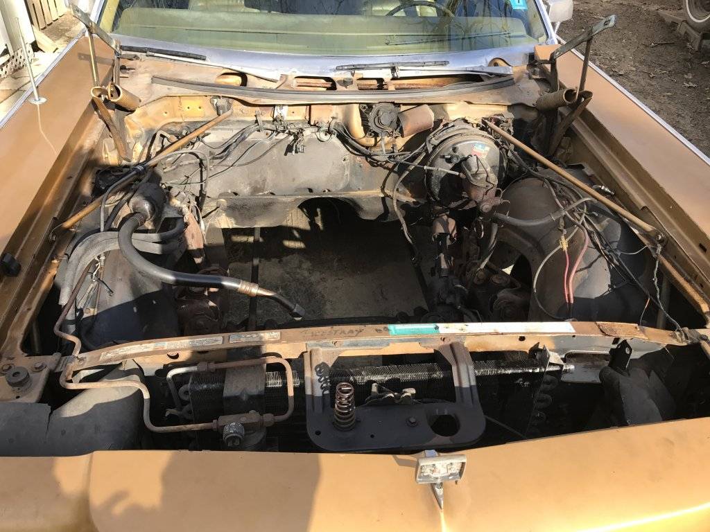

I never thought to ask when I posted this, but do you know where it goes through the radiator support?
You can see it run along top of the fender well then in through one of the existing holes. This is the ‘73, some of these openings might be different than the ‘70.
